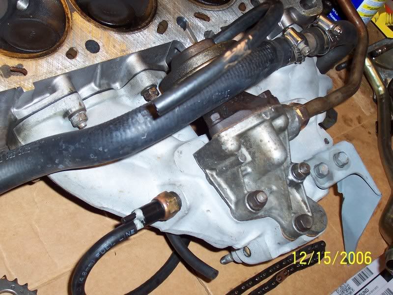

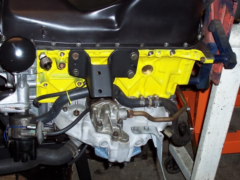

Dan is right, there is a tee where two of the coolant hoses attach under the intake. This would be the first place you should check for a leak in that general area. The hose that routes around to the front of the cylinder head is called the bypass hose, and I had to replace mine.
It was part #19644 and cost me $9.73 plus $7.05 shipping, from RockAuto.com.
If it's the other hose, then you're going to have to ask someone else, as I still am using the one that came on the LUV.
I also had a water leak from using the wrong gasket on the intake manifold. For your case, it doesn't seem that you removed the intake.
Image Image
Here is a not-so-great photo taken of my head upside down, with the intake manifold still attached. You can see the two hose clamps holding those two hoses onto a tee. There's where you should find the leak. The second photo is from the first time I removed the head. Because of the difficulty in removing the EGR tube, I just removed it all together. I was able to get the EGR tube out of the exhaust manifold later, but I never got it out of the intake manifold to this day. That EGR tube must be removed from either the exhaust or the intake before the intake manifold can be removed from the cylinder head.

Where does the other hose go? Do you know the I/D of the hose? I could patch something in if I have to. Excellent pic, thanks! I really had no idea what I was reaching for earlier. Is the T tapped into the manifold? Is there an easy way to get at it? I sure can't see it from up top...

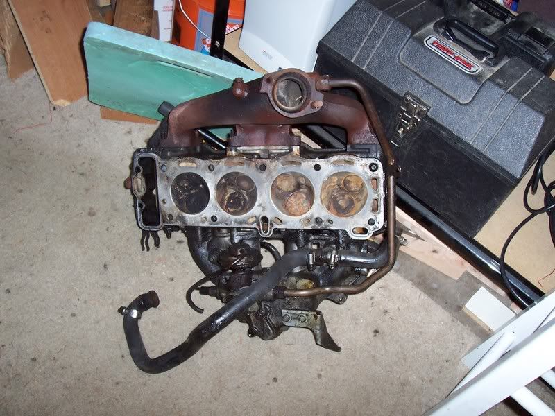

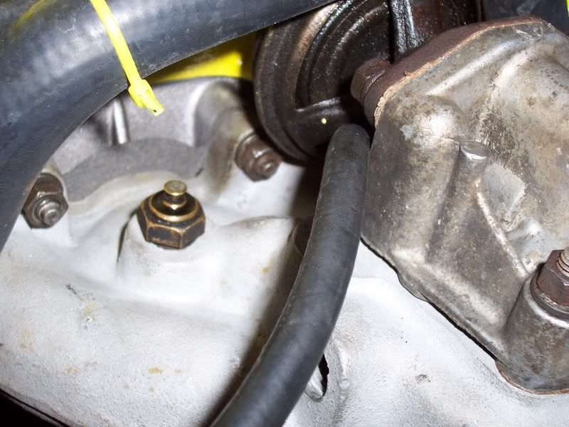

Yes they are a pain down where the sun don't shine and you have hoses galore to cope with. If you have several different types of wrenches you will make the job much easier. I have another photo for ya. This one is of the hose routing placement. I couldn't read the sticker on the hood well, but I found that when I took a photo of it and resized it, then added some special effects I was able to get a real easy-to-follow drawing.
I had to remove the thermostat/radiator hose to remove the carb, then remove the hoses and the intake. The second hose on the tee goes to the heater core. Yes it is connected to the intake manifold. Coolant flows through the head and through the manifold. The water temperature sensor is on the intake manifold. There is also a thermal vacuum valve connected to the water galley on the front of the intake that has two hoses attached. I had trouble keeping mine intact, and broke it twice. Repaired it twice.
If Ctmandu offers you a helping hand, man, take it. He is one of the nicest people you'll ever meet.
A tip: Try using a small mirror just to eyeball the area. I even used it to do the work.
Image Image
Image Image
Click on the first photo, then right-click and save it to your computer. Then print it out on a full sheet of printer paper, and tack it up in your shop!!
