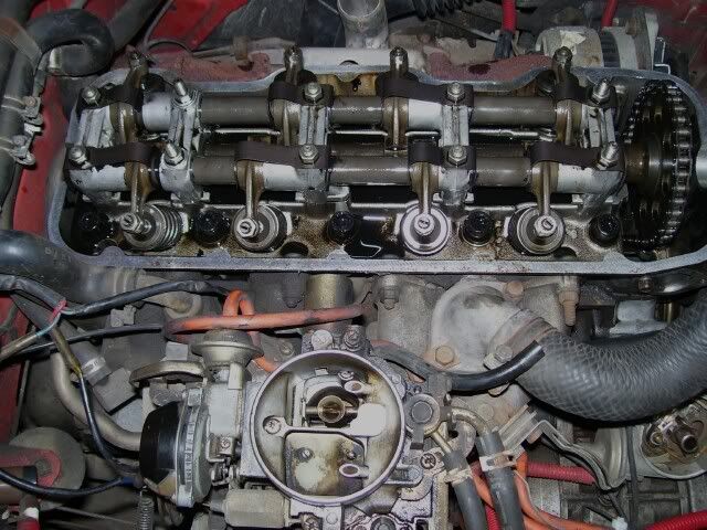

Gonna do some general tightening this weekend. Think I read somewhere about the valve cover retaining a bit of oil after shutdown. What I am wondering is, can the valve cover be removed without making a huge mess. Or does the oil need to be drained before removing? And will the valve cover gasket survive?
Plan is to check/torque my headbolts, since I have no idea if or when they ever had been.
TIA

There is nothing wrong with doing a little preventive maintenance once in a while...good idea.
Once the engine is off, the oil all drains down into the block so if you take the cover off carefully and have a rag handy, you shouldn't make any mess. Then while you are there, you might as well check your torque on your rocker assembly bolts and adjust your valve clearances while you have the cover off.
Then you can clean the inside and the outside of the cover off real good, and maybe give the outside a new real purdy paint job..lol
And never ever put the cover back on without replacing the valve cover gasket set...unless you like real messy oil leaks.

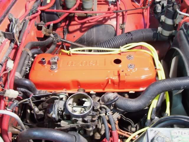

Just finished with the re-torque, checked and adjusted valves... only found a tiny bit adjustment needed on #1 exhaust, #3&4 intake.

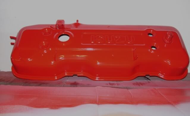

Picked up a new gasket set today, will let the new paint on the valve cover setup and reassemble tomorrow.
Carb is next, and then the countdown to my repaint project starting the weekend of March 12th.

And the install is complete, no as orange as the camera makes it look. Also added some new plug wires.

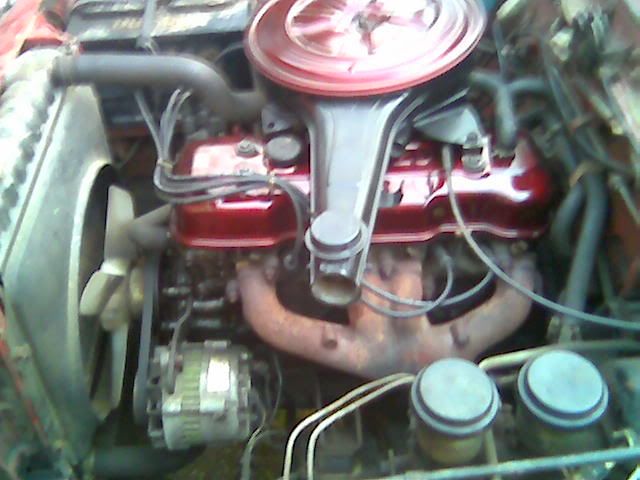

I stripped mine down and used Chromalusion paint on mine. Also did the breather cover. Turned out pretty good, I'm happy with it.

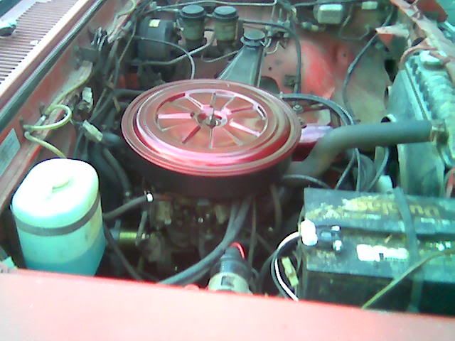

looks like a theme going on here
That has to be one of the cleanest engine bays that I have ever seen.
1980 LUV Mikado 4X4
2003 Chevy S10
PostPosted: Mon Feb 26, 2007 9:41 pm
its really messy and dirty but thanks ... one day it will be clean though
