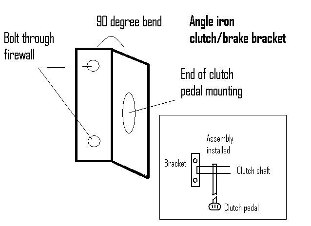

I think for a lot of us, the problem has already developed, I know the '78 is downright scary. The weld to 'repair' the clutch pedal is scabbed in, and I pretty much expect the whole thing to fall off at any moment. On the '79 4x4 the previous owner did a really nice job with a 90 degree angle iron bracket. I don't have any decent photos, but this is what it looked like (more or less)...
You can see that this got mounted on the end of the clutch shaft to prevent movement...
Really simple, and it gave a very solid feel to the whole clutch/brake assembly. I think he cut the bushing down about 1/8" to allow the bracket to go over the end of the shaft. It had the stock clips on the end of the shaft.
