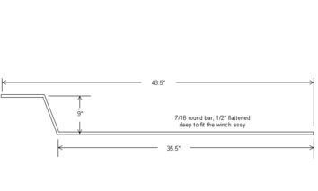

I am doing some body work to my truck that requires I remove the bed. I need to remove my spare tire. It looks like there is a specific tool used to remove the spare tire. I have one of these that came with my truck, but It is at my house in Spring Hill, KS.
Either I need to borrow someones, or I need to know if there is a way to do it with normal tools.

Here's a drawing of what you can make for a spare tire tool...
