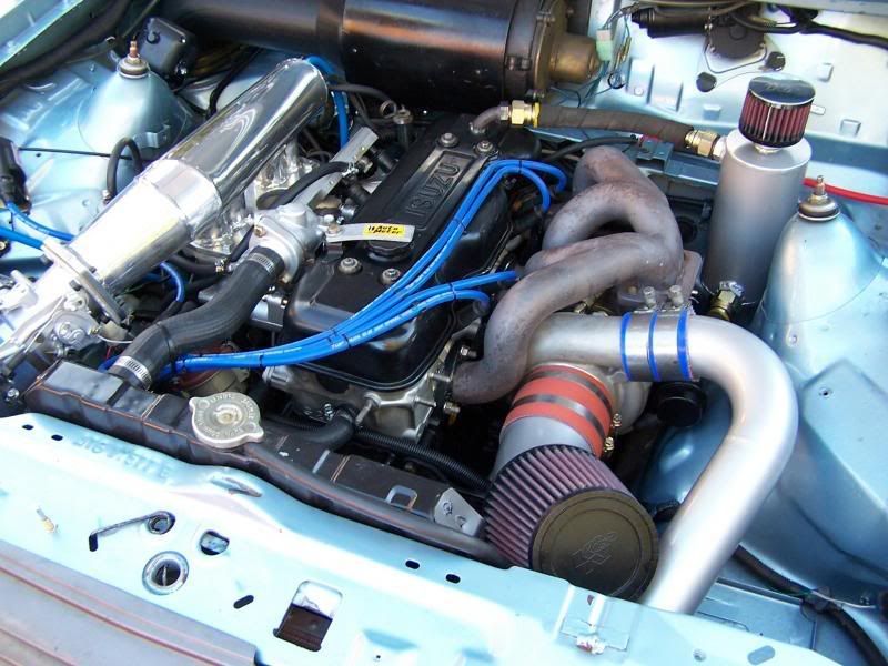

i think that catch can you posted up is a little "ricey" if you know what a i mean.
anyways, check out the catch can on this engine. alot of turbo guys run catch cans from the blowby that just happens in a boosted application.
you could probably find a way to make it so it self drains, so that there will be not checking and emptying of a catch can.
and yes, thats a hardcore turbo'd G200 :twisted:
