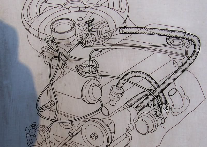

Anyway, if anyone has a 79 luv that runs okay, i need pics of the air filter setup, and where all the vaccuum hoses go. And another picture of what wires hook to the coil and resistor, my dad thinks something is hooked up wrong, because we had an electrical short. All the power went out.. but i think i fixed it. i just unhooked the main power cable connected to the positive side of the batter (the one that powers the lights, ignition, radio. etc..) and made sure it was making good contact and it worked again, so i guess im not really worried about it. But a pic with what wires go where would be great still.
And about the air filter, we think one of the hoses is hooked up wrong so its drawing out oil or something because there is a LOT of moisture from the exhaust, and it smokes heavily. But then again that could be from everything being brand new, being from us rebuilding the engine.

Look around the site and you will find a lot of this has been covered. If you click on "Information" on the home page of LUVTruck, you will find electrical wiring diagrams of whatever you have. Try the "Search" tool at the top of the forum page to look for anything. Here's the hose routes;
'78 1.8L 4-speed Fleetside
Image Image
