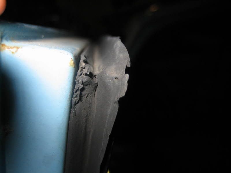

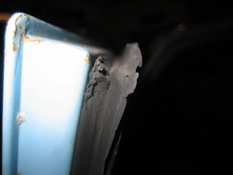

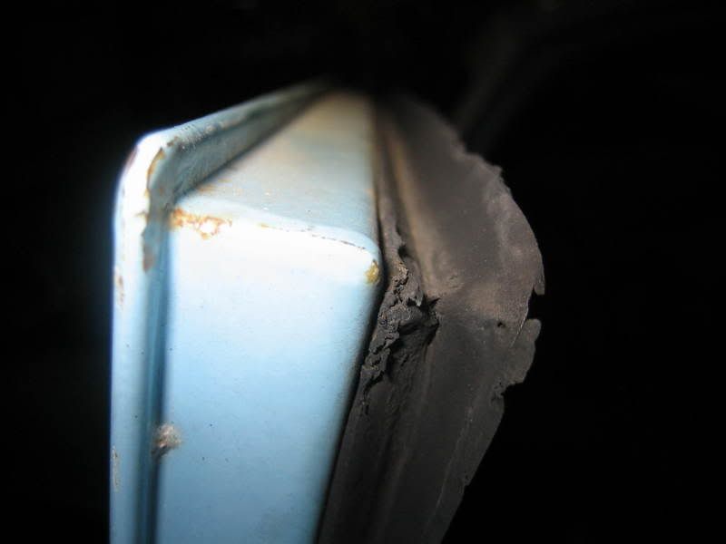

should look like this. Kind of backwards form what you would think. In my opinion. I stripped all mine off then when the new stuff came in I was scratching my head. Luckily I had another truck I could look at.
