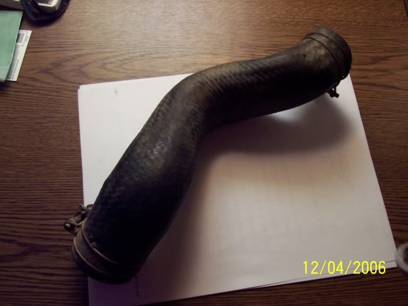

Here's a couple photos of the hose. BlackLuv80: You should get your payment very soon!!! LOL
There aren't any numbers on the hose. Maybe if I wash it with soap and water I might be able to see some numbers, but I measured it, and it's a 2" inside-diameter hose, so perhaps that info will help. It's pre-curved and about 13½" in length. I bent the measuring tape to the curves to get the length.

You Should Have Seen It Before I Cleaning It. :lol: Ever Heard of Red Georgia Clay? Need I Say More?

Why you done washed off the numbers!!! I needed that dirt to make my tomatos grow bigger! LOL

Well I Guess That Means No Luck on A Actual Factory Part Number. Sorry, Maybe Someone Else Can Round It Up.
