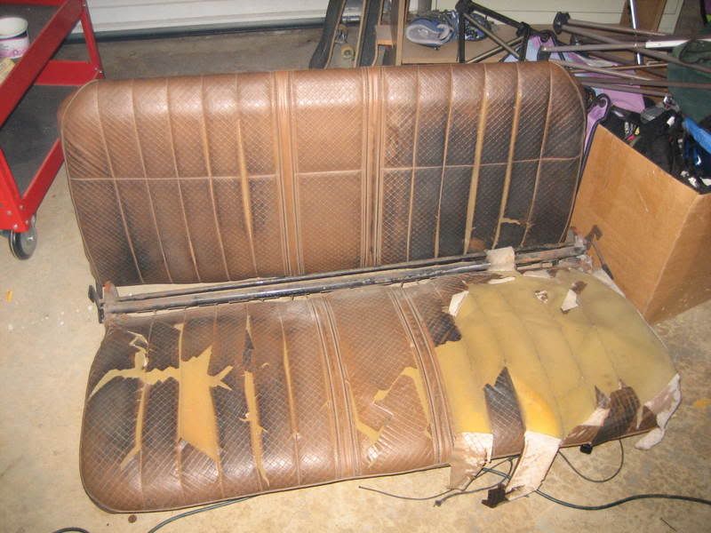

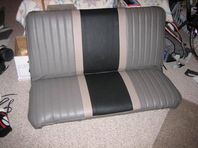

just finished my upholstery project over thanksgiving. built them form scratch. upholstery is tough work these guys definitely earn their money
before
after

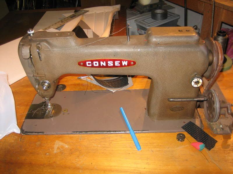

Old industrial machine a picked up for the job.

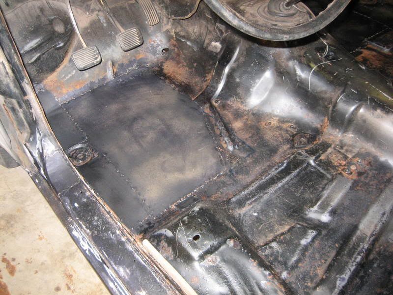

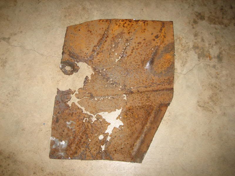

Floor pans
Before
After
fixed rusted rocker
just like the dentist cut out the bad
weld in the new

making that seat fit right was hardest things I have done on a car.
but now my $350 luv has and $85 seat. At least the materials were $85. Probably could have done it for under $50 with a single color.

Hi fullaluv, yup it's an 80. the floor pans were gone on both sides. Only thing I can figure is that the water got in and sat for a very long time to rust that bad. It is the hazard of being a car in WA state. when I bought it the seller was proud that he had a piece of ply wood cut to size that sat over the holes with some plastic tarps folded up acting as gaskets. I should have taken some pictures of that. it makes me want to start a thread call "Fixes Gone Wild" or "101 Ways NOT to fix you Luv"

found the sewing machine on the craigs list for $80.
Vinyl materials were $85 only because i did 3 colors
Hog ring pliers $10 at harbor freight.
If you have a home sewing machine I would try that first. Believe it or not most home machines can do it also. The biggest thing you need to be successful is make sure your needle, thread size need to be matched for your material thickness. Here is the link that helped me figure that part out.
http://www.gwsms.com/didyouknow.htm
My big leanings form the upholstery projet were.
1. Get correct needle size and thread size for material thickness
2. Cloth fabric would have been easier that Vinyl for first project
3. Don't make it to big, measurements need to be exact and you want the fabric to compress the foam some so you don't have wrinkles
4.doing you fitting with you cover inside out will help you get the fit correct.
Sorry I think I am going to hang onto my sewing machine still have some more projects to do. Door panels and carpet next. if you don't want to do the sewing part I also saw many companies out there that will sell you a seat cover kit. I saw prices from $200-$300. Then all you have to do is remove the old and put on a new cover if your foam is still good.
