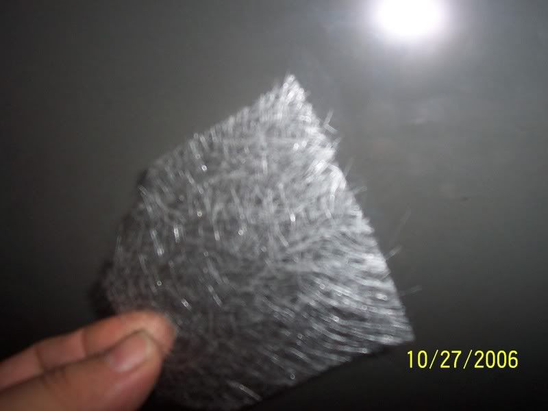

The hole was repaired using what the POR-15 company calls "Power Mesh, steel reinforcing fabric", which is applied right on top of the first wet coat of silver and more silver applied on it. The paint is allowed to dry and more coats applied, resulting in a hard coating. I still need to put some underneath the repair, as per the directions. I can detect some "give" in the finished repair where the hole was, but I believe after the liner goes in and the mats are in place, there won't be any perception of weakness.
Here's a photo of the mesh...it's fiberglass.
I liked the fact that I did this all myself at home, and didn't have to get the vehicle worked on at a shop.

So To Make A Long Story Sort Sheet Fiberglass Without Using Reasin
If I Cought All That Right
Never The Less It Should Be Strong Enough You Will Have To Coat It Good On Both Sides To Prevent Water Damage
