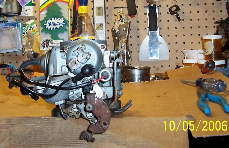

My electric choke is no good. The heating element fell out, and I think I need another choke unit. Any one out there got an electric choke you would part with? Maybe some one who went to a Weber??? My LUV is a '78, and the carb is a DCP340.
Image Image
