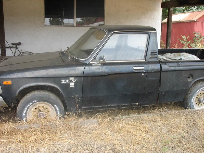

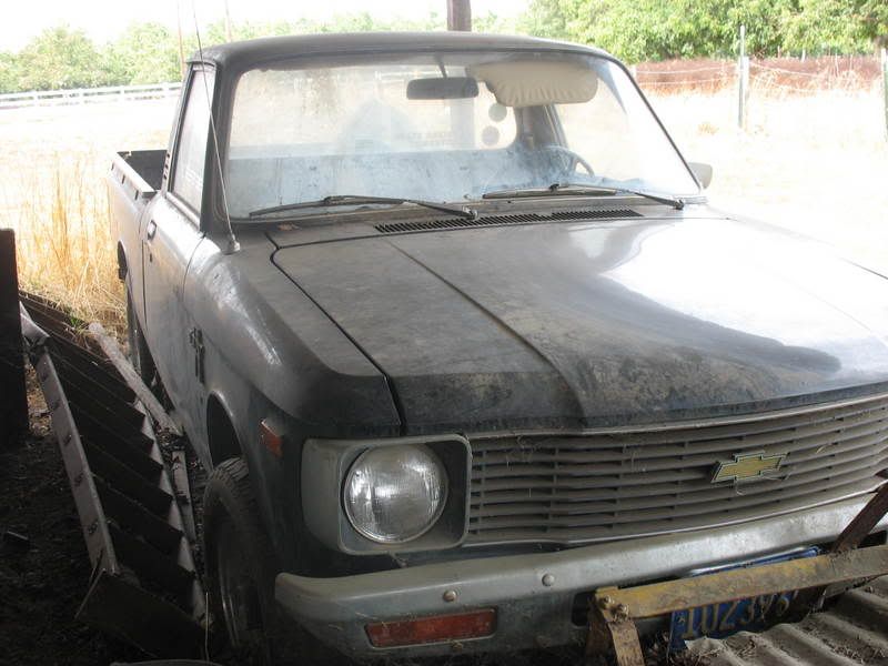

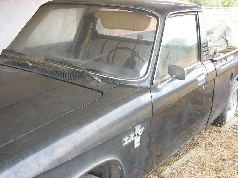

Hi everyone. I am back, and i have photos of my luv!
It wasn't really a g ood time of day...the sun ruins it. Tuesday im going to get some interior and engine photos up.

Looks like a good starting point.

looks a hell of a lot better than what i started with
oh yeah.. where are you located??
