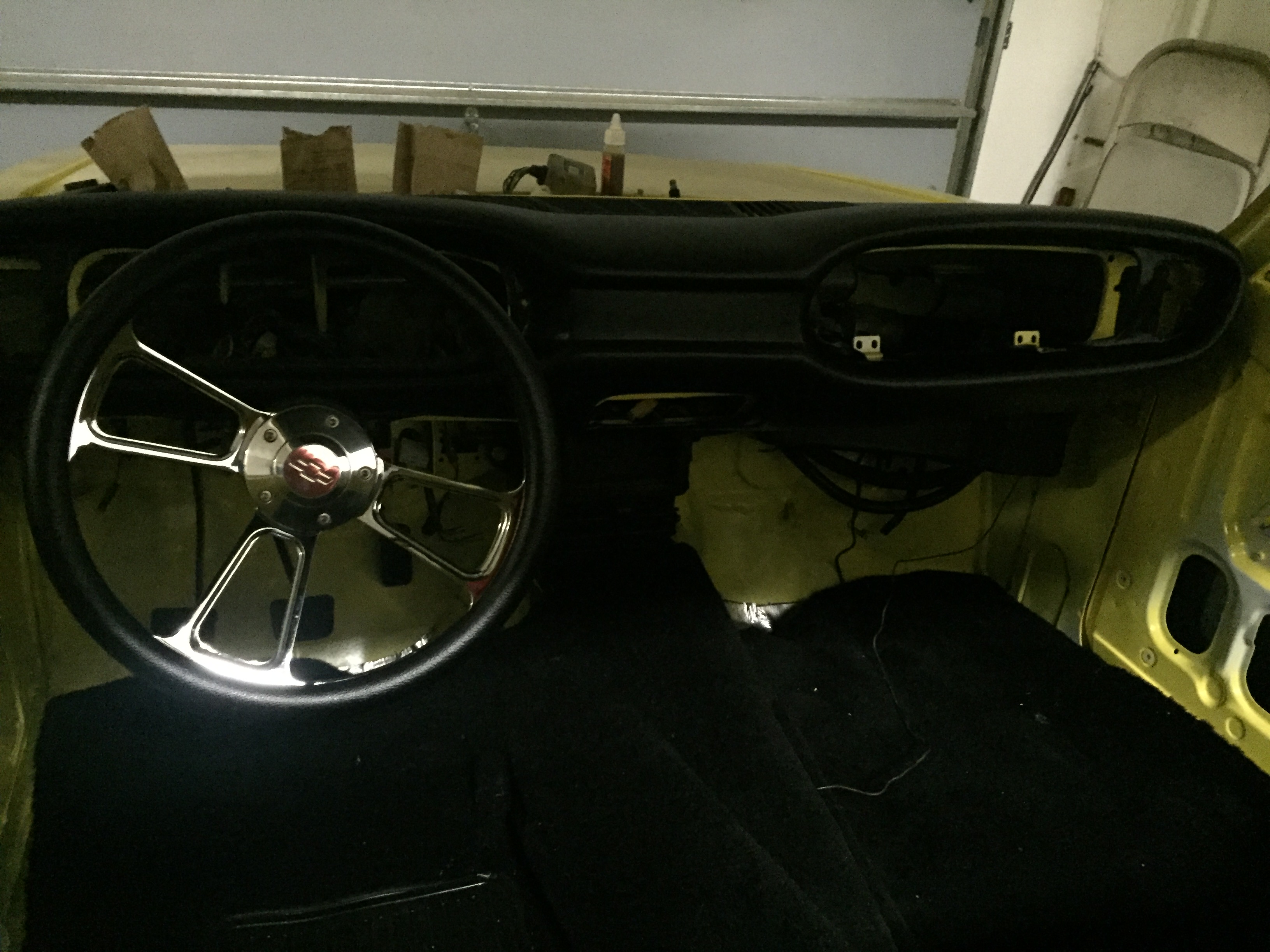

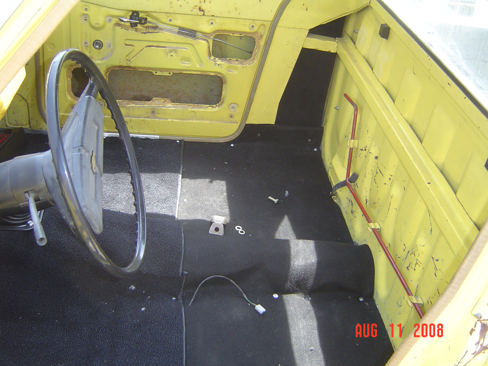

I took my G200 engine and G180 head to the machine shop to get it rebuilt. Got to take the cam on Monday, I was running late so I didn't dig it up. I want the internals balanced so he asked me to bring him the flywheel and clutch. Hopefully it turns out good.

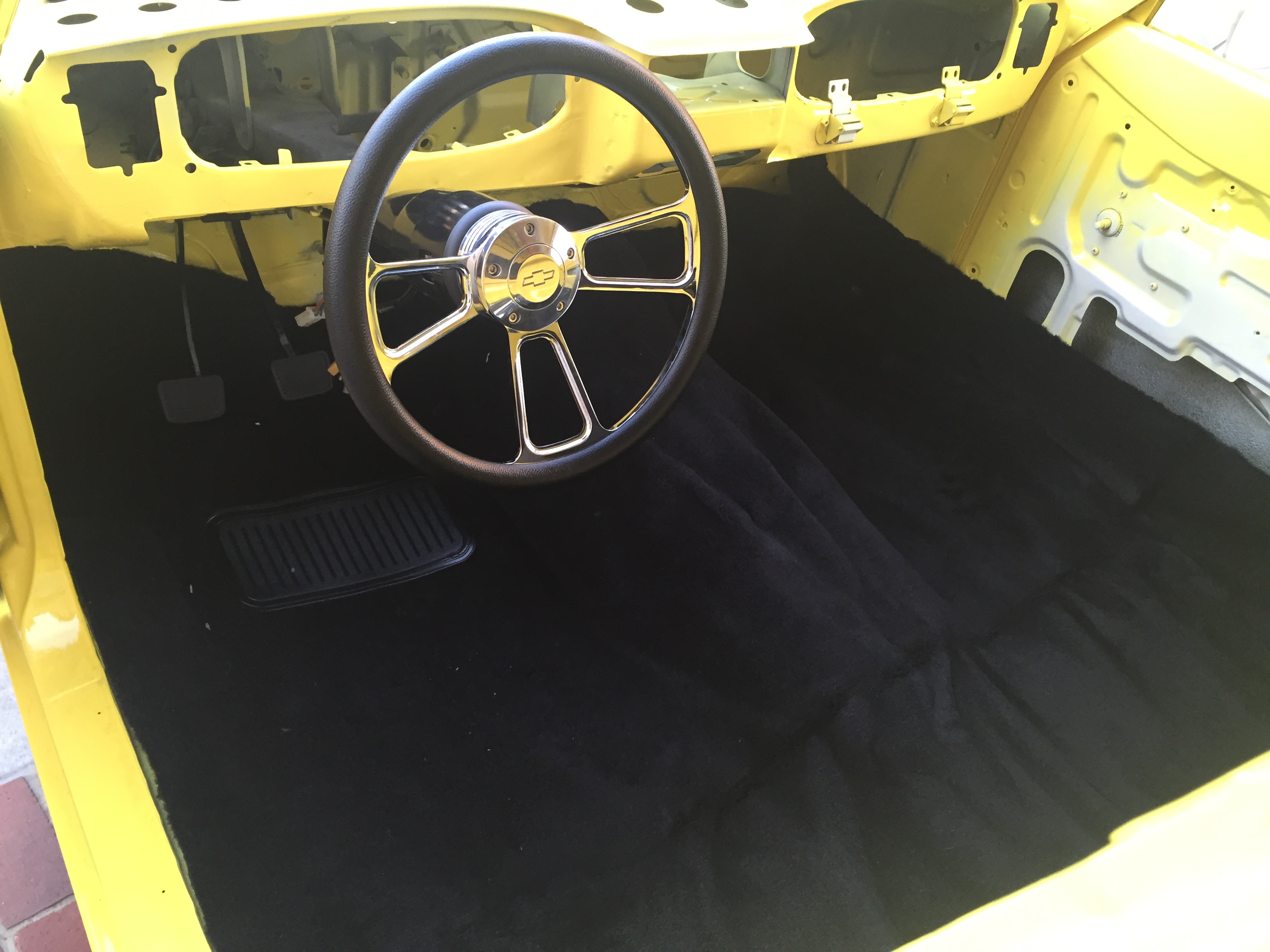

I also put in the sound insulation and threw the carpet on top and it doesn't fit right. Anyone know of a company that makes one that fits like it should? I bought this one on the Internet. This one will need a lot of work to look ok.

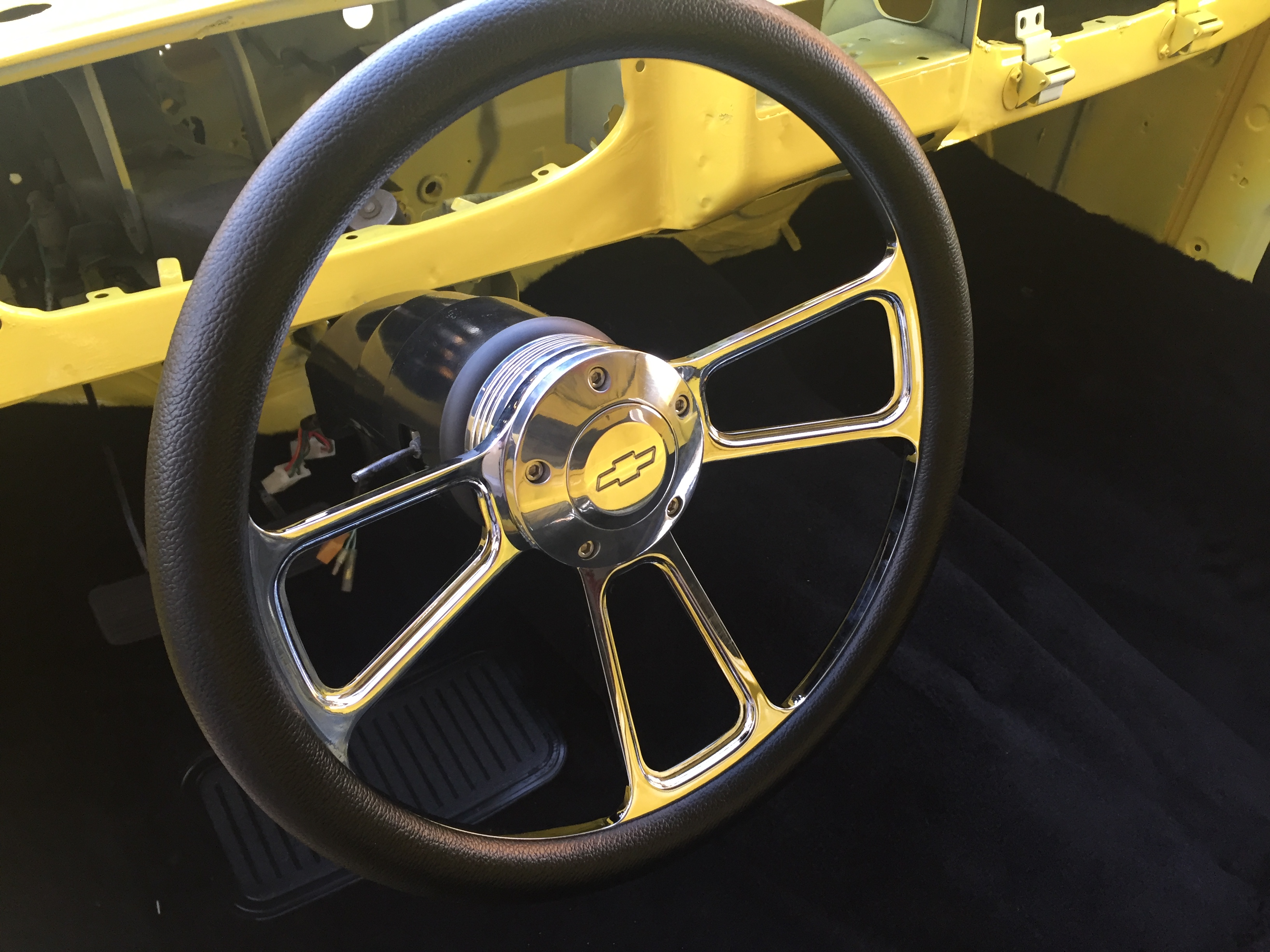

While I did that I also installed the steering wheel.
PostPosted: Sat Dec 05, 2015 8:29 pm
I 'think' all of the carpets come from the same manufacturer. I modded my trans tunnel and expect some issues due to that. A GOOD upholstery shop can fit what youhave. They have to cut and seam it. You can use the 3M spray glue and start in the middle doing a section atl the time and stretch it to the ends and trim if you're patient. You have to let the glue set before you do the next section...

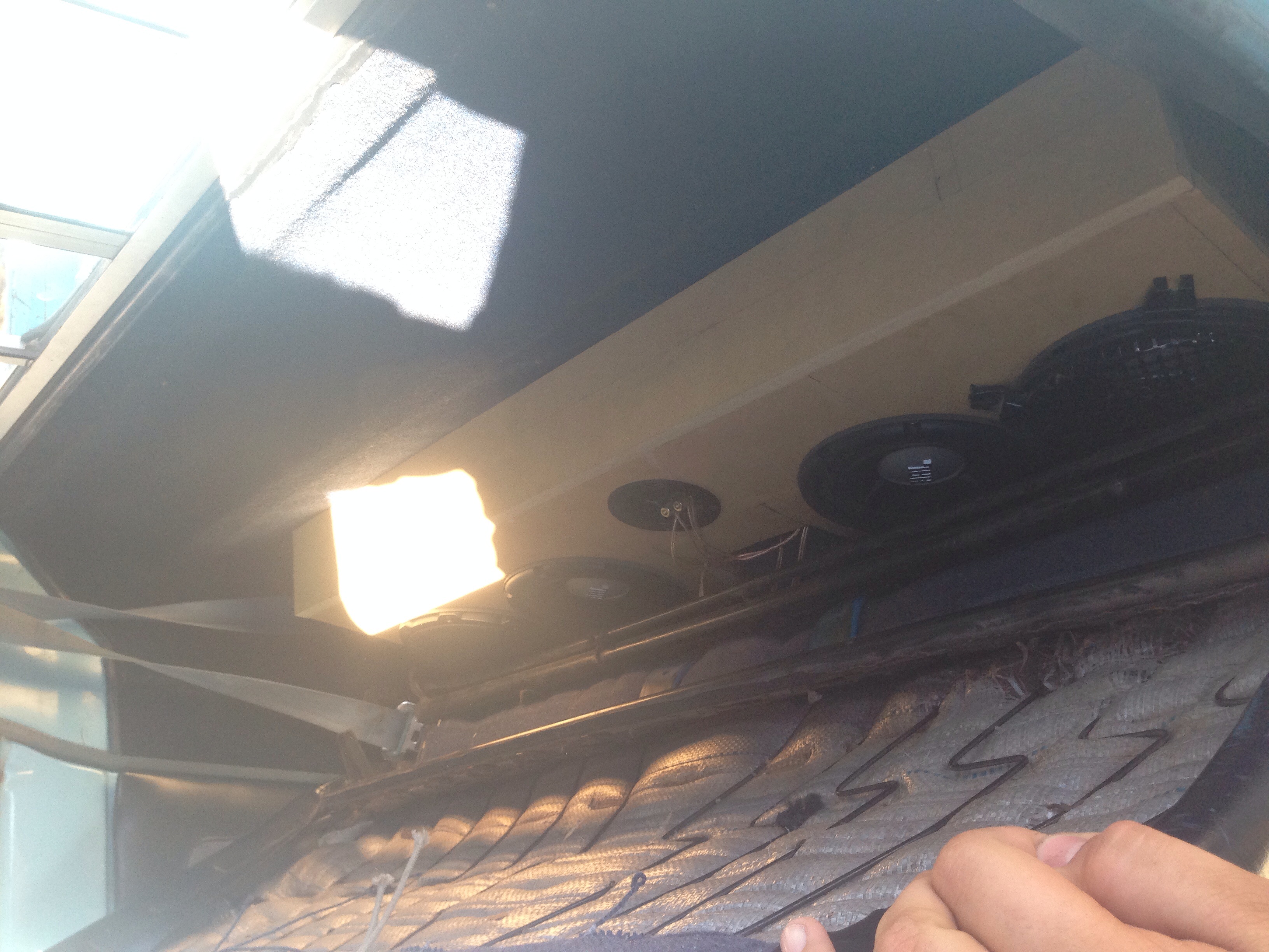

PostPosted: Sat Dec 05, 2015 10:20 pm
Posts: 115
Here is a picture of the box that fits 4 8" jbl subs. Installed with a 1000w rms pioneer amp and a high output alternator and the little truck bumps!
Dang, I'll try. Thanks
That looks like it restricts movement of the seat all the way to the rear. Does it?
PostPosted: Sun Dec 06, 2015 11:15 am
Posts: 115
The seat slides back all the way without touching the subs/box. A lot of measuring went into the building of this box. I'm 6'3 and it would suck to not have the seat all the way back :lol:

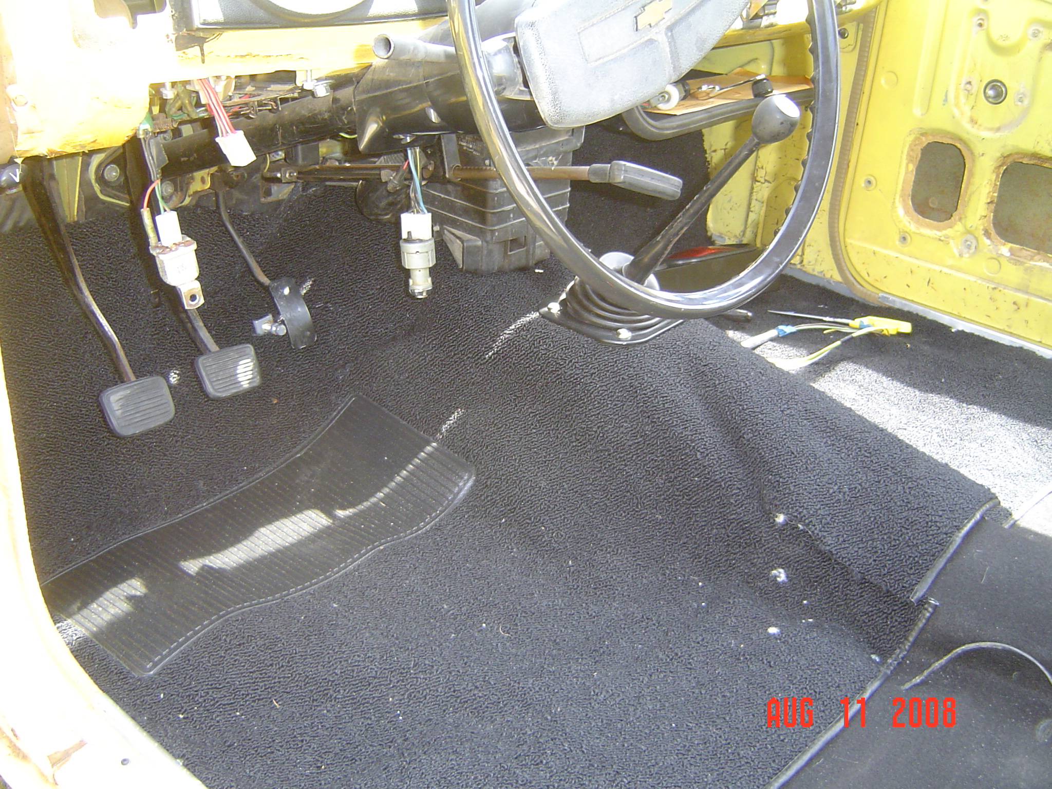

PostPosted: Mon Dec 07, 2015 12:03 pm
Posts: 607
I LUV seeing all your doing to this LUV.....Thanks for sharing your progress.

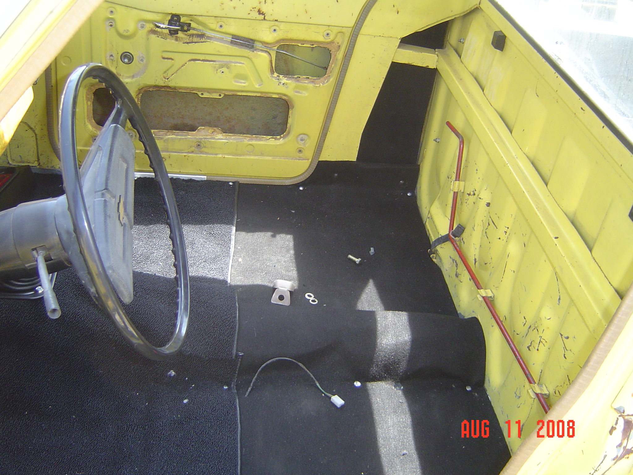

When i re-carpeted mine a few yrs back i found an good deal on a new old Chevy kit on eBay i think it was late 60's
impala. 66-68 it was preformed for the hump and i positioned the heal pad and trimmed off what hung out the doors
and only put a few self tapping screws near the edge of the hump to hold it in place along w/ my shift hole plate and side
metal pcs and used some black felt material for the floor to finish up to the back wall since its under the seal & saved the
other of 1/2 of carpet to hang on the back wall.....(which wasn't done in these pics).... Here's a couple pics of mine

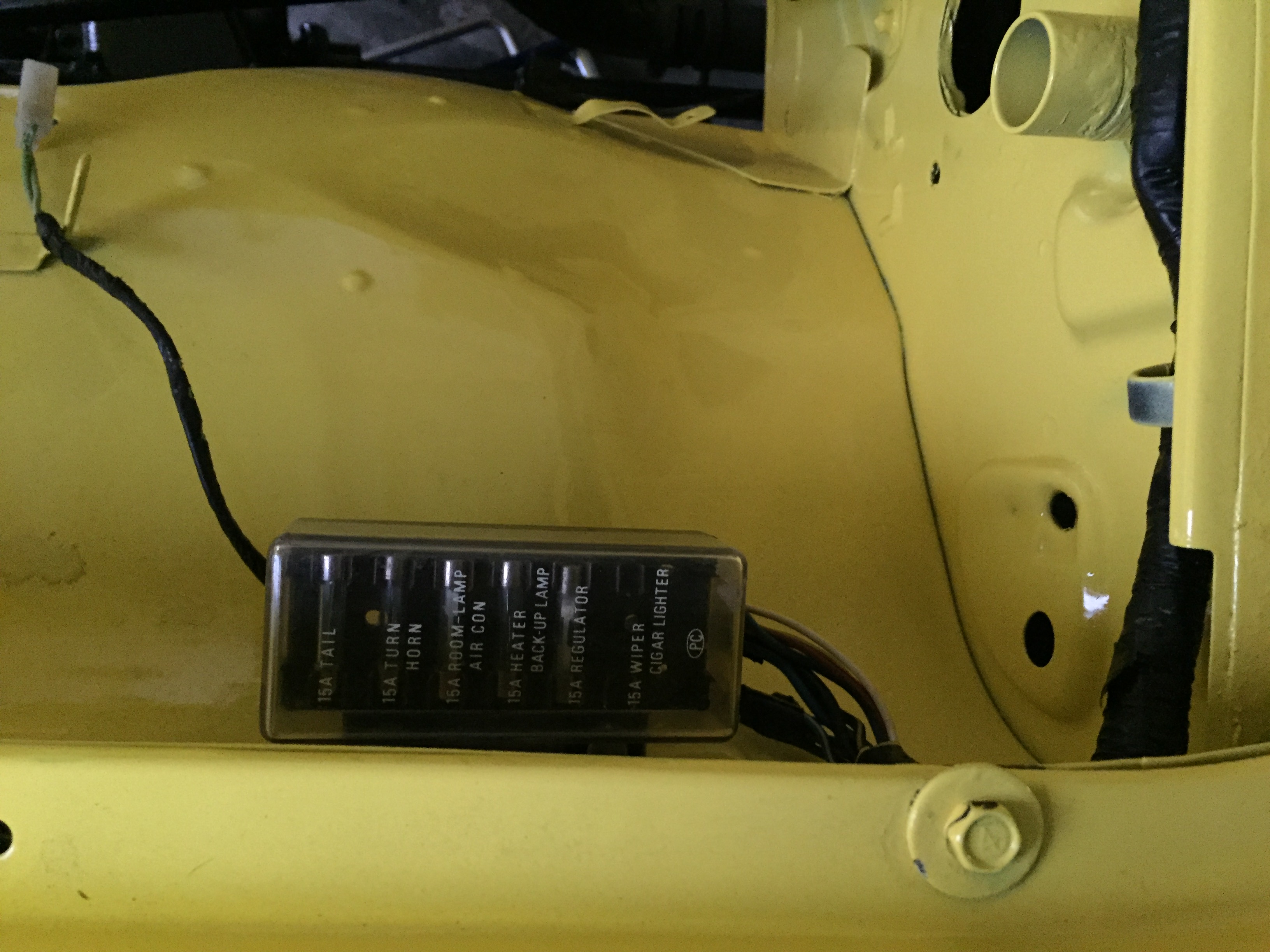

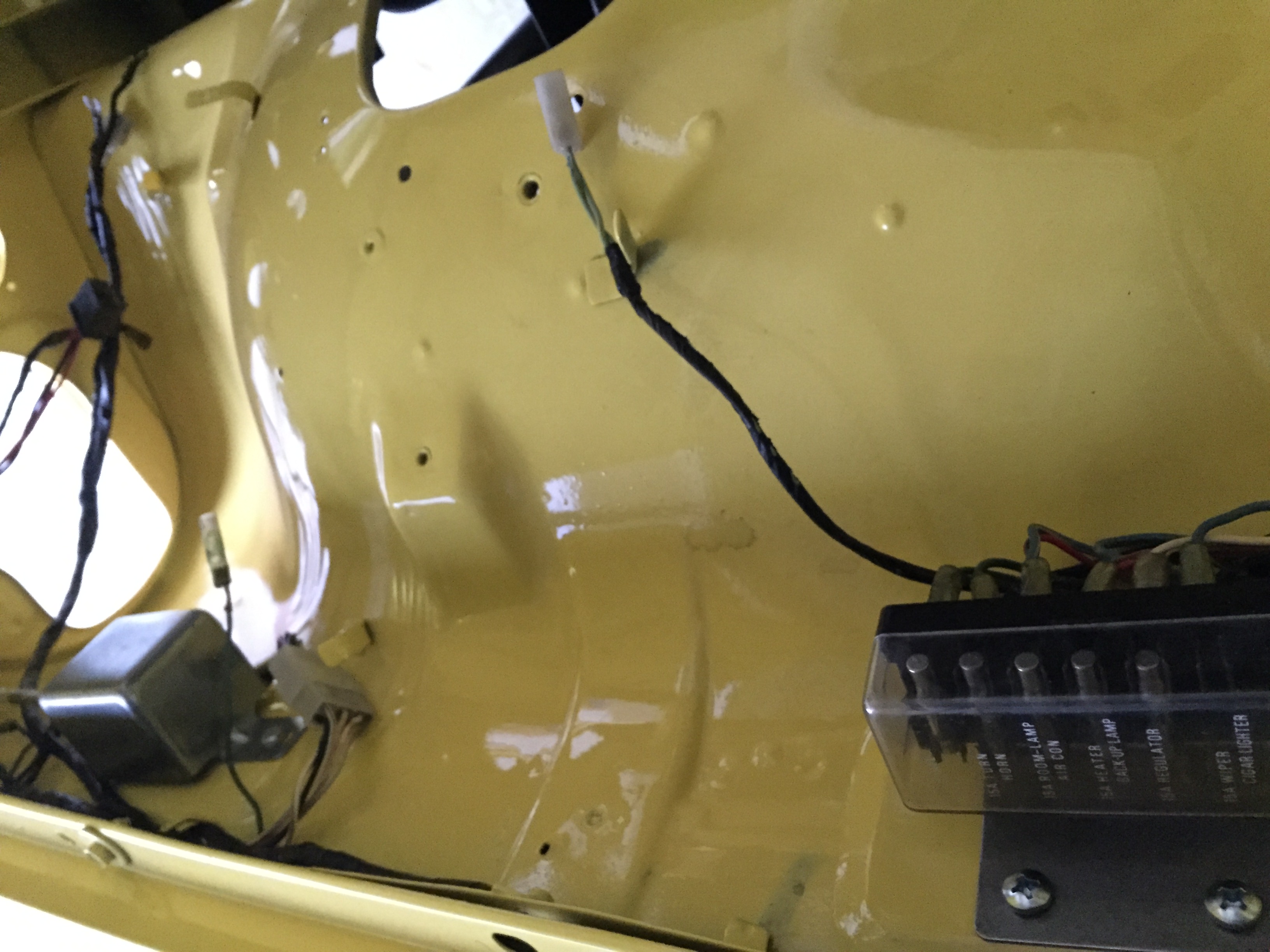

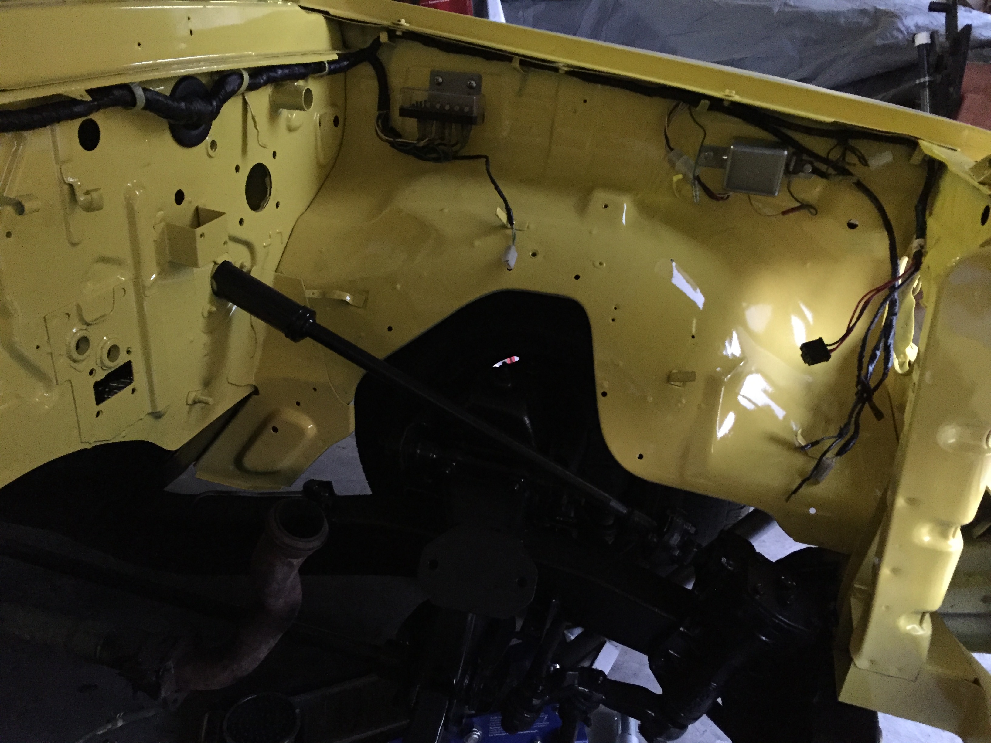

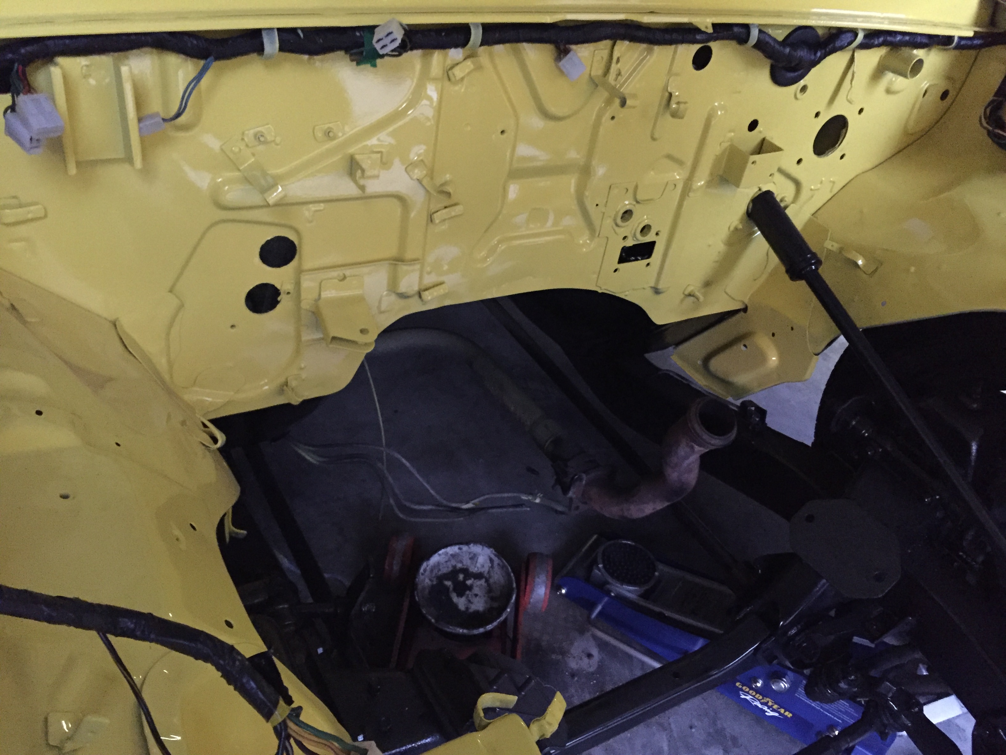

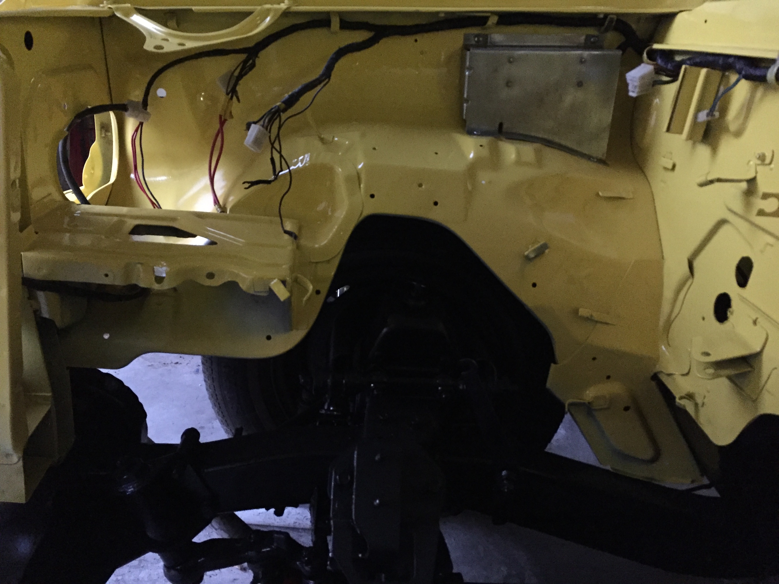

Started to put the harness back in.

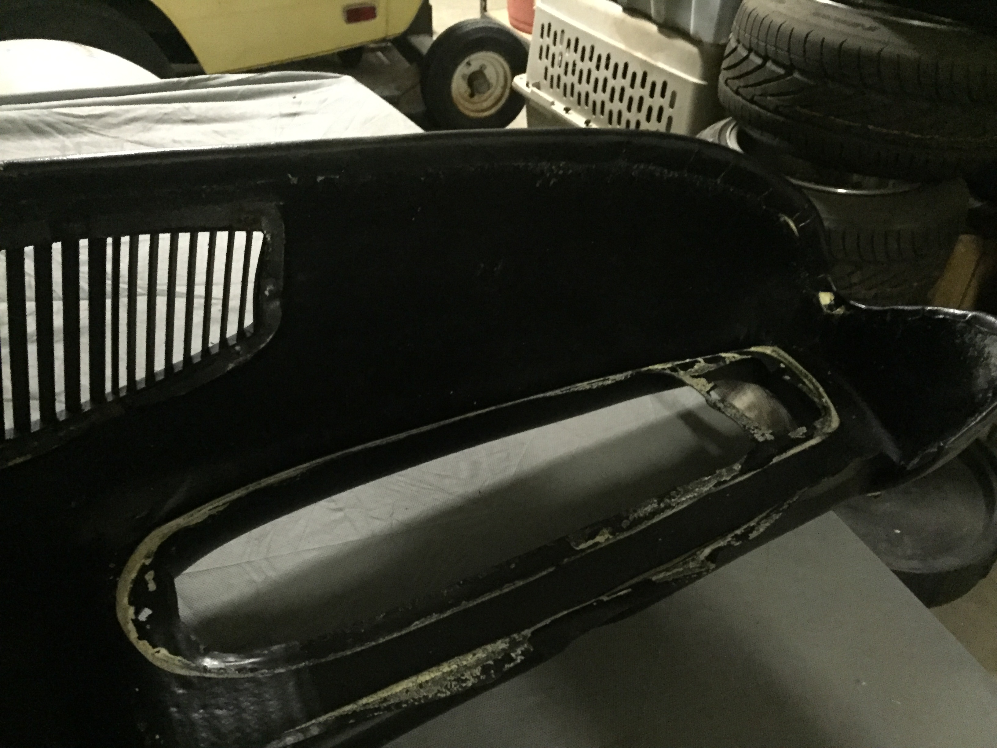

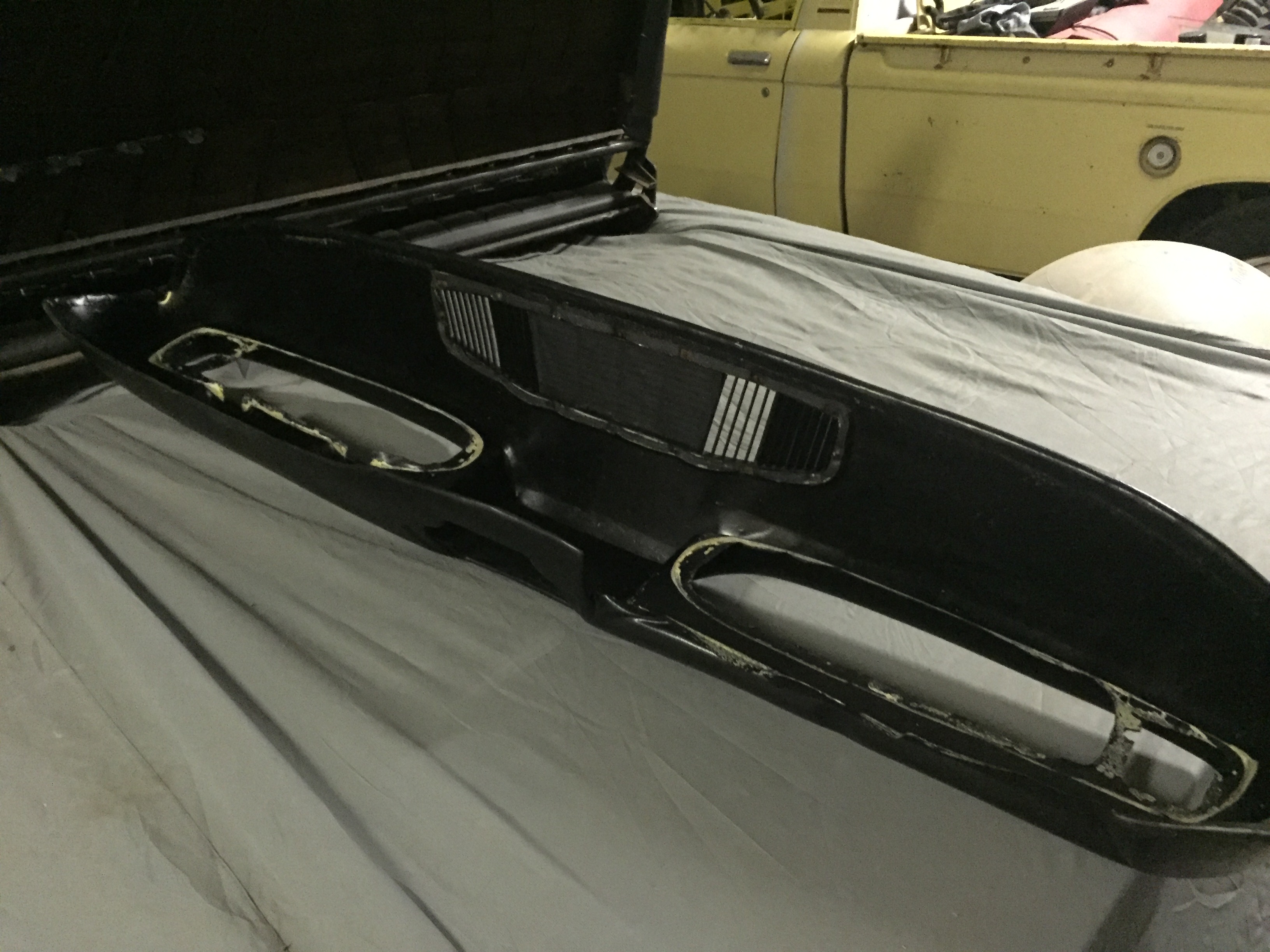

Posts: 262

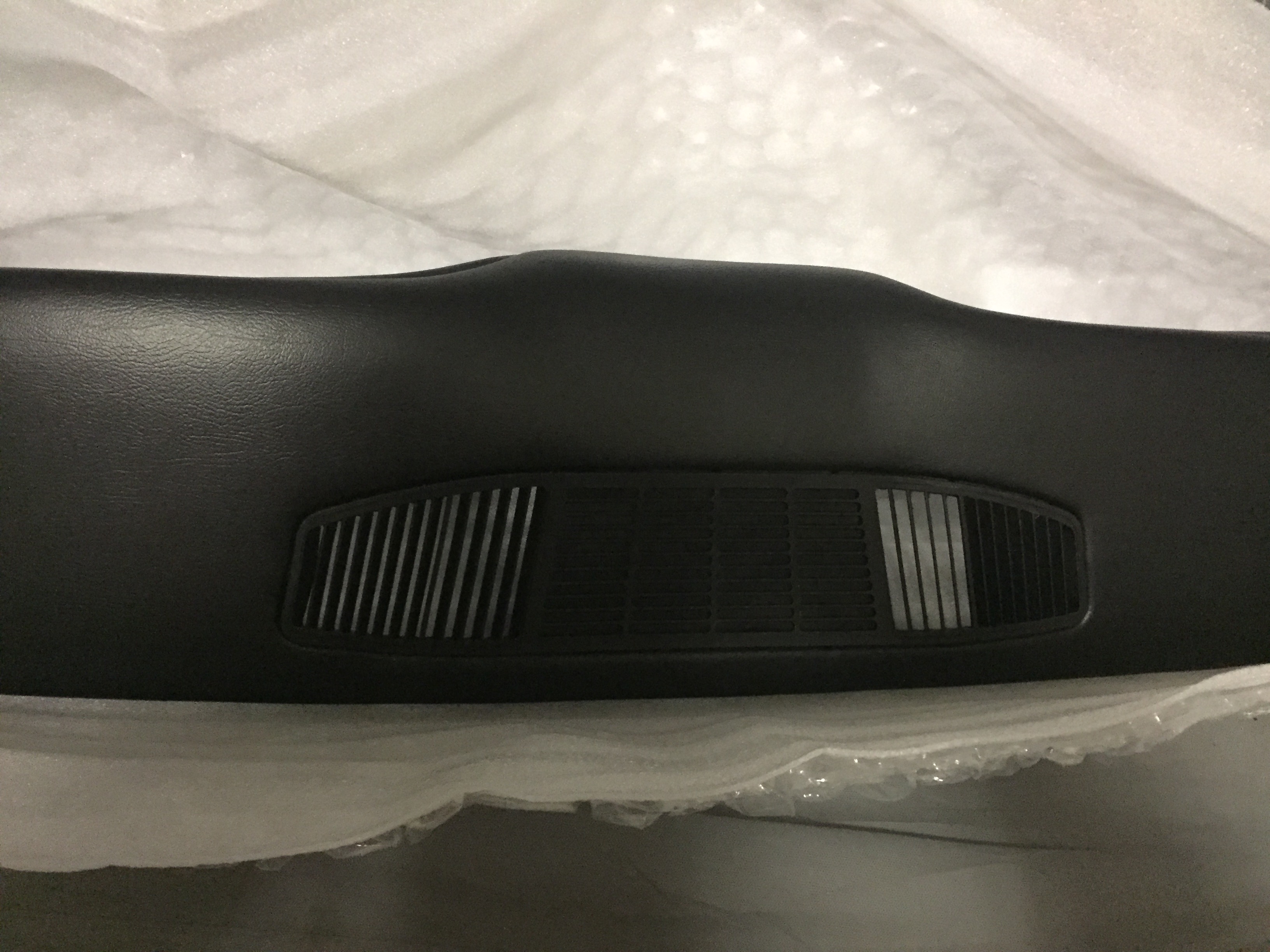

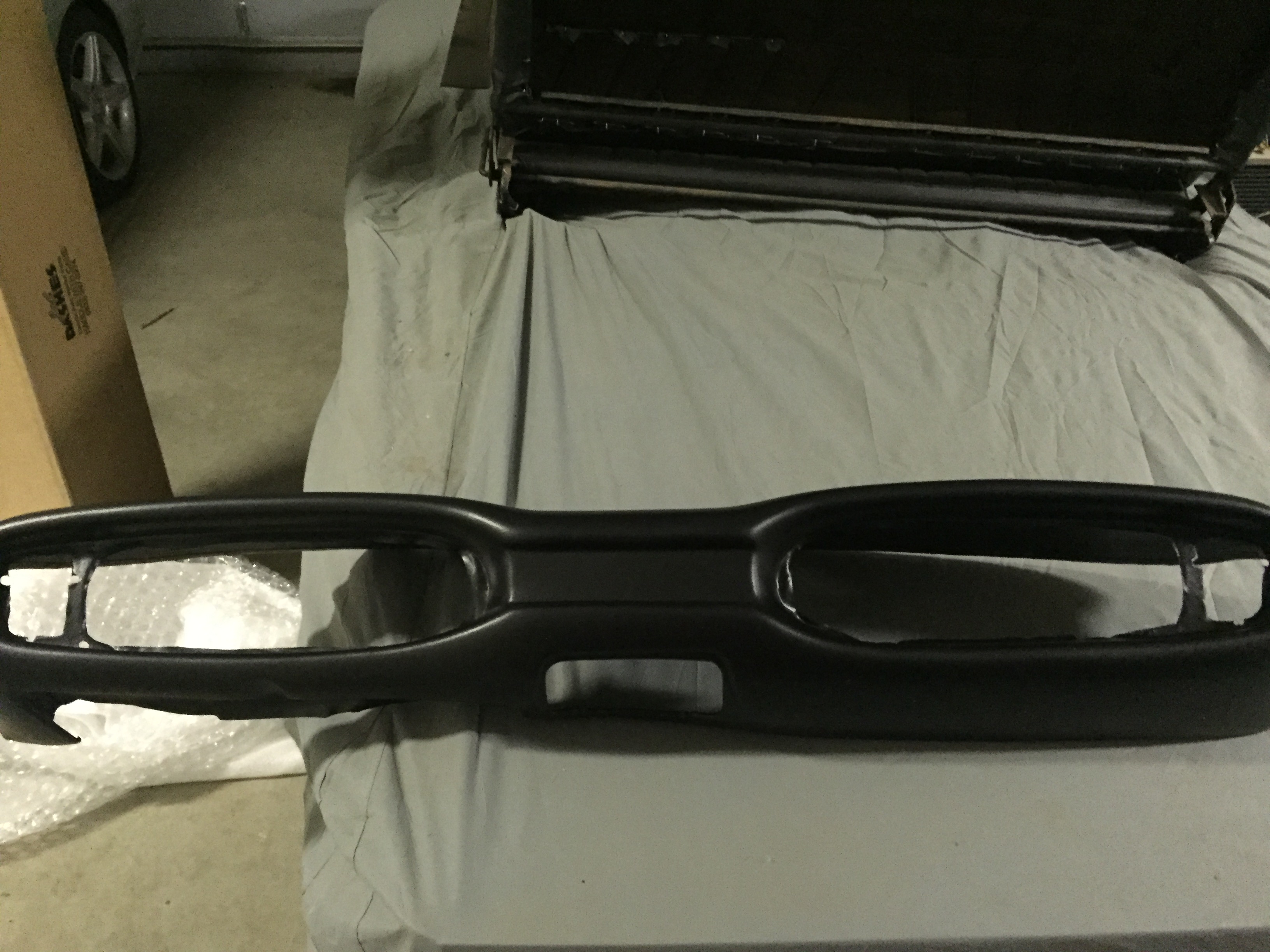

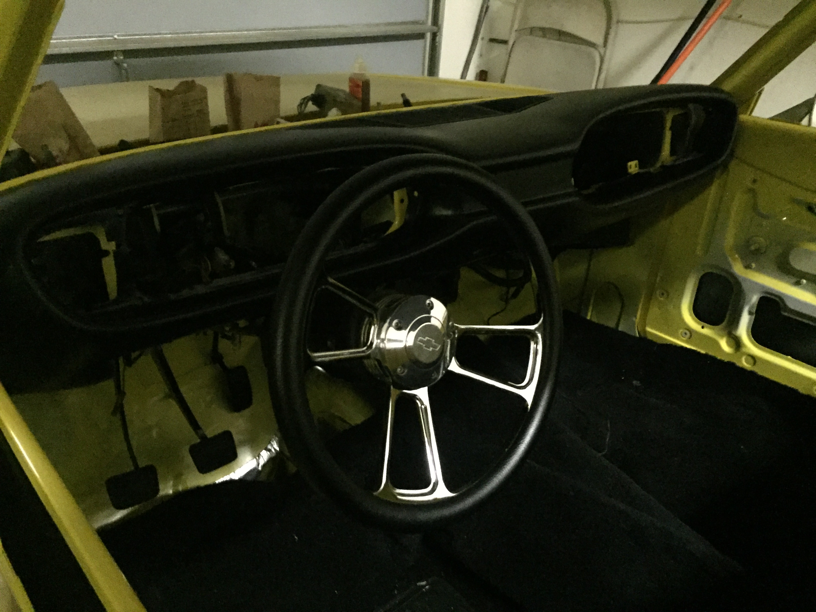

Dash is here.

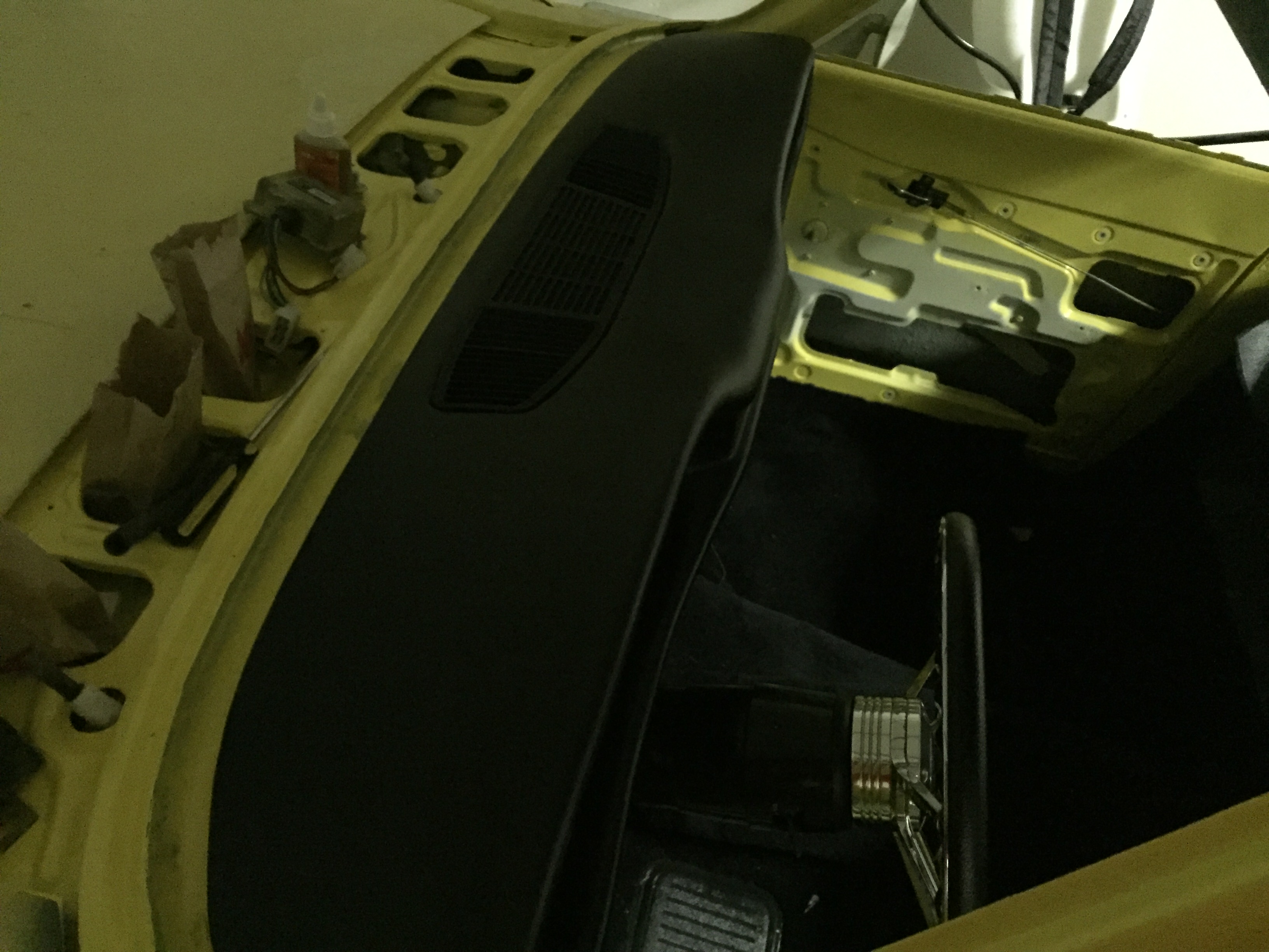

PostPosted: Thu Dec 17, 2015 8:45 am
Posts: 262
Turned out great.
