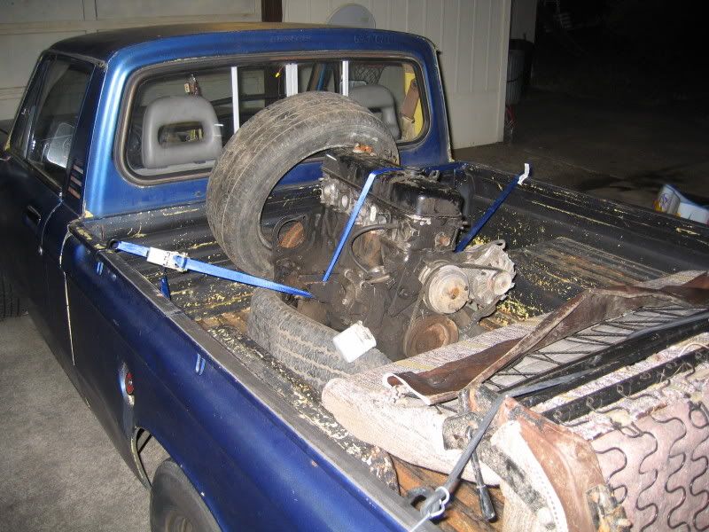

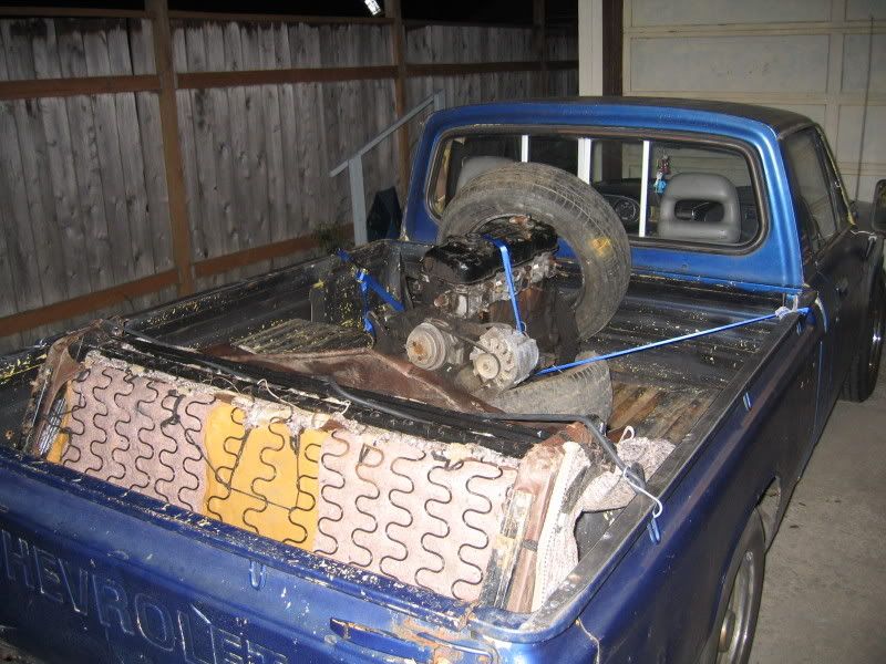

Okie, got the replacement engine today, from a 2x4. Not sure how long it's been outside, but I'll check with luvprojects on that. Any prep work I should do before bolting the manifolds on? The engine is basically complete minus the intake and exhaust. Do I need to clean up the valves or something if they've been out in the weather? I don't want to pull the head, but I'm thinking the engine might go in easier if I do. The head usually has the lift points for the engine, right? I need to take another look at how I'd drop it in without the head. Even has the motor mounts, are they same between the 2x4 and the 4x4?
Really like some input here, as I'm not heavily experienced in the engine guts department. It's been almost exactly 20 years since my last engine swap. Wow, am I that old already? hahahaha...

Squirting some WD40 or something similar in the plug holes and then turning it over by hand to take care not to screw up the rings (plus it helps to re-seat them) is something I always do on an engine that has been sitting very long, especially if it's had the intake and exhaust manifold off.
And if it were me, I'd spring for a complete gasket set too. That way it's easier to have less problems later by taking the time while the engine is still out to clean off the tops of the pistons and the valves, to replace the timimg cover seal, to replace the front and rear seals, to replace the head gasket, to replace the pan gasket, to replace the valve cover gasket and seals, etc. It's a pretty cheap investment in having some peace of mind and staying worry-free.
You could also take a lot of extra time and money to paint it all up real nice and purty, plus bling it all up by adding tons of neat little stainless steel and chrome goodies to it too, but that doesn't make it run any better, and IMHO engines are supposed to run well - not be a fashion statement...lol
Just my $.02 worth.
