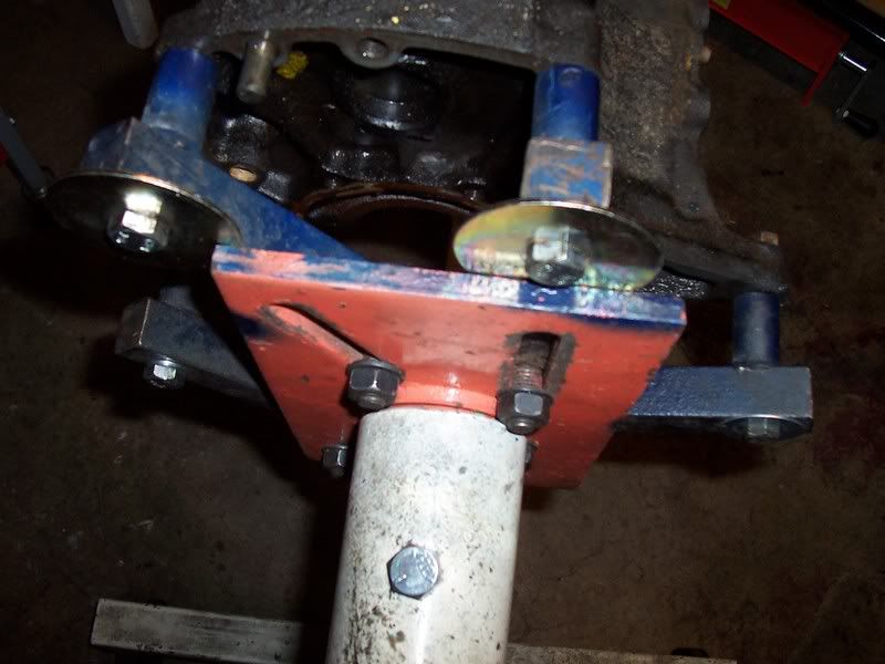

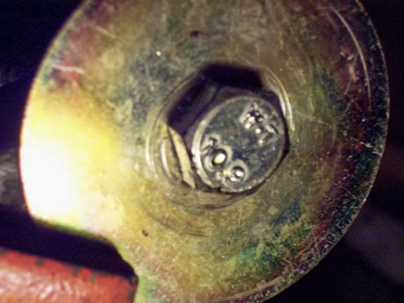

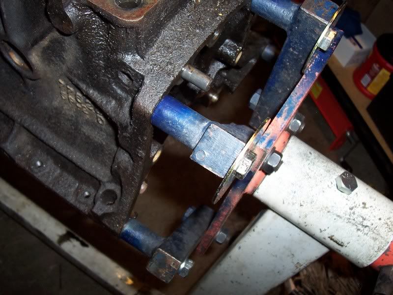

For enlightment purposes, here's how I mounted the engine on the stand. I used hardened bolts, grade 10.9. My engine hoist package used 8.8.

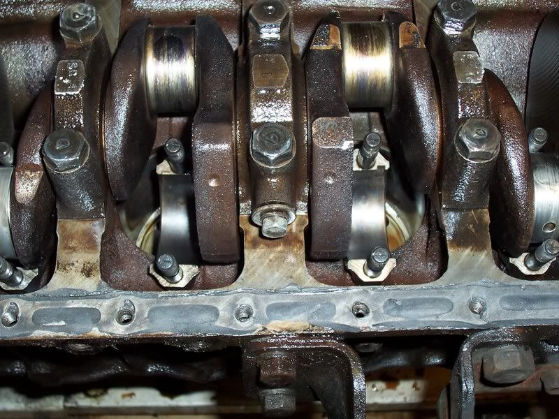

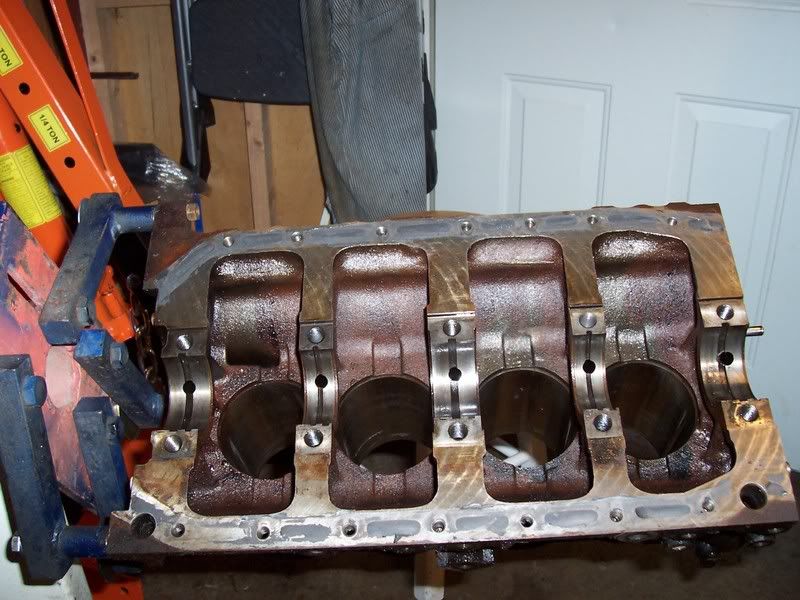

I also have come up this morning with another thought about the prior engine failure. I see the rust inside the block so much clearer through the light of the photo flash, and I would suggest that this block never should have been used before hot tanking. A lot of time and expense would have been saved by doing it right the first time. This block was doomed to fail from the sloughing off of the rust scale and subsequent oil galley blockage.
Image Image
Image Image
Image The hardened bolts were size 10mm-1.25 x 80mm. They cost almost $3 each. I needed three; the fourth bolt goes through the top starter mount and can be any type with a nut.

Hey John I believe that rust you are seeing is in the water jackets hence could not make it into the oil gallery.

Image Image
Hi 74-MIKADO, I surmise that this block should have been cleaned in a hot tank, as when I first got it there was a lot of water in the engine. The photos above show the crankcase after a couple hundred miles of driving, and I am soon to have another block to compare this engine crankcase to when I get the block from the machine shop next week. Do you see how heavily rusted the engine crankcase is? I don't doubt that the bearing material was the main clog in the galley, but the rust couldn't have helped. It's probable that a series of circumstances created the engine failure, not a singular one. If it was obvious I would be quite content but I did a careful job the first time around, just not careful enough. This time is going to be very intense. Enjoy the ride, and thanks for all your feedback.

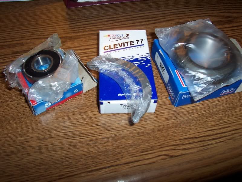

Also, now that the eng. is out, spend another $20 and get a new throw out bearing and a pilot bearing for the clutch. It's a lot easier to do it now than it is to pull the eng again later just for a $20 part.
While the crank is at the shop have them pull the old pilot bearing out for you, because you need a special small puller to get it out. You can use a socket as a driver to put the new one in.

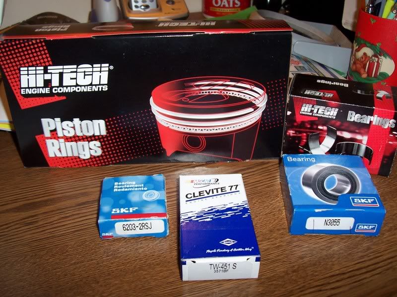

I am facing the most exciting time of all this week. There is a newly machined block to pick up, a reground crank, new pistons, new chrome rings, new head gasket, and it's all coming together inside on an engine stand!! I'm going to be photographing like heavy, and you all just enjoy the ride.
Image Image
Tools are ready/Pilot bearing, thrustwashers, and clutch throwout bearing.

These are molychrome-plated rings for $70 from PartsAmerica. I ordered at Schucks, so they arrived in two days.
