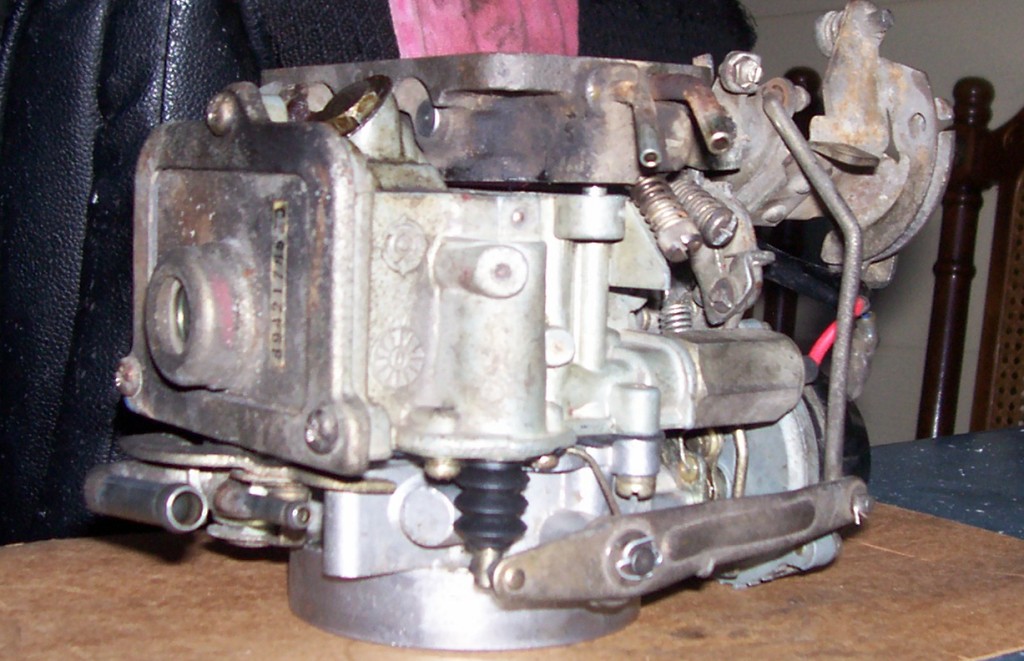

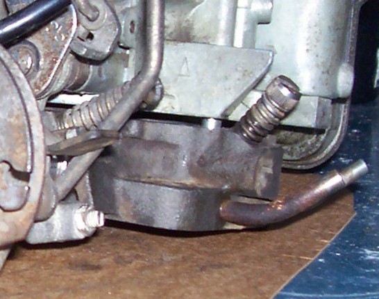

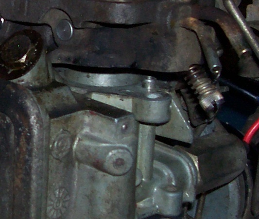

So a friend came over & we got it to fire and idle, but barely & not for long. Very weak & erraric. Seems like there was too much air or not enough gas. Then he noticed on the barb where the main body & throttle body meet... there is a gap. I can wiggle the gasket. It wont tighten down any further. Sux as I didn't do that part of the rebuild. The metel tube coming off the main body wont go all the way into the hole for it on the throttle body. WTF? How do I handle this? It's the stock DCH340.
PostPosted: Thu Dec 09, 2010 7:02 am
Posts: 1204
Location: Salt Lake City
take a picture, im having a hard time understanding what you're saying... :?:
PostPosted: Thu Dec 09, 2010 10:09 am
Posts: 130
You can see the gap & angle with the metal tube. It wont sandwich down together flush. The gasket doesn't make seal. WTF? How the heck do I fix this?

PostPosted: Thu Dec 09, 2010 2:04 pm
Posts: 680
Location: Cornelius Ore
There are screws there from the bottom to hold the throttle assy to the carburator body, did you tighten these?
If it will not seat, then remove the assy again and realign the dowel pins to seat it properly, do not force, it will fall together easily when everything is aligned properly.

I'm confused. There is only one dowel tube and it is lined up but it's hole isn't deep enough to allow it to fit all the way. I just don't get it. The kit came with a thin gasket for this spot. Does it need a spacer?

Yeah, the hole in the main body is clean. The dowel is part of the casting on the main. The hole serves some purpose as the recieving hole in the throttle body only goes in 1/16th of an inch in fit diameter, but the center hole opens right next to the primary butterfly. I guess someone rebuilt it before me or the manufacture did something weird. If I was to drill or grind, lowering it down changes how the linkage all meets up. Should I try that step anyhow? The gasket pattern is too small for me to make my own gasket. Does anybody have a stock DCH 340 or simular that they can check if this joining location is a flush meet or gapped by a spacer or thick gasket?
PostPosted: Fri Dec 10, 2010 6:53 pm
Posts: 155
Location: Sturgis, SD
I found the rebuild kit I bought a few years ago all I used out of it was the accelerator pump and the carb to intake gasket I think. Anyway the gasket in this kit that you need is the same thickness as two quarters stacked flat on top of each other about 3 milimeters 1/8th inch.
1980 4x4
PostPosted: Fri Dec 10, 2010 8:06 pm
Posts: 680
As I remember the gasket was fairly thick, 1/8th inch sounds about right. The tube is usually staked in place. I would try tapping in down lightly with a hammer, it may drop a bit. Sounds like someone has kind of messed it up for you.

So I used a cork/rubber material & got it all back together. Then when started, she started right up fine. Seemed to need a slight timing adjustment & fuel mixture done, but then after like 5 minutes or so, it died. Then when I tried to restart it caught and backfired very loudly. I took off the aircleaner and noticed that the choke butterfly is lose and flaps around. Is it right to assume that the linkage isn't set right and when it heated up the kickdown & choke didn't work right? Could this also cause the backfiring?
