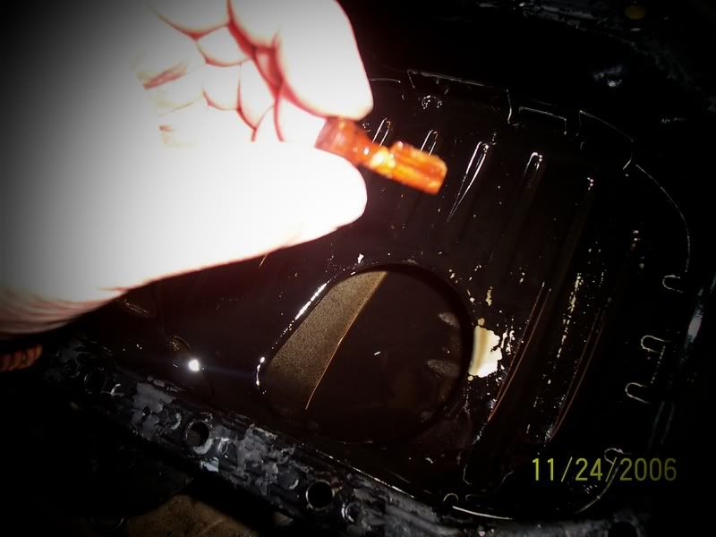

Today I removed the valve cover to see if maybe I could stop the noise by a simple 90º turn of the adjusting screw, and I found it had disappeared! Oh well, I dropped the oil pan, and here it is from the very bottom:
I'll be doing the timing chain cover gasket job after all. I don't know if I'll do the rings, or if I'll replace any of the other timing parts.

I've got one with a chain tensioner that is like that. I never did fix it but it isn't a daily driver. Since you have a good excuse to pull the timing cover anyway, might as well get on with that project. Sometimes they just decide for you what you are going to be working on.

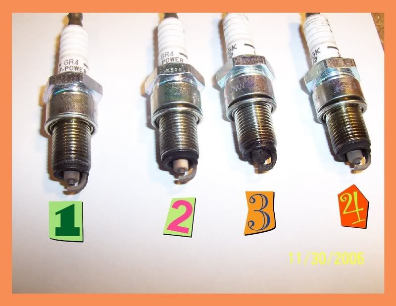

Oh man. I got into the engine today. I was taking things apart, and when I got to the spark plug removal, I found that the #3 plug was badly sooted.
Remember I'm looking for the cause of oil consumption? Now I'm thinking of doing a piston ring job on just the one cylinder. Here's the plugs...
Image What do you guys think?

It could be rings, but a bad valve stem seal on #3 intake valve would be more common.
