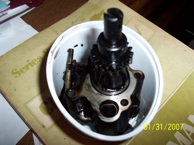

I got the failed engine all apart and about ready to come out of the truck. I can't figure out what caused the oil starvation, and I want to ask:
Is it possible that since I replaced the timing cover that the oil never got into the oil pump? That the only oil that the crank got was from splash? The oil pump was full of air; it doesn't have to be primed or filled with oil does it? I am going to be spending a lot more money that I don't have on another engine rebuild. It better work this time.

Yes the oil pump should be primed and the oil filter filled with oil before screwing it on the engine. I have had great success over the years by filling the oil pump with vaseline before installation. Just pack all the cavities of the pump full before installing. You can use motor oil but i have found that vaseline stays in the pump better than motor oil. If you have any fears of the vaseline plugging the oil filter it can be changed after you get the engine running. I have built a few engines and have never changed a filter after starting a engine and never had any trouble. I also use vaseline on all main and rod bearings when installing. It stays there. There are lubricants made for engine assembly but i have never used them and i have never had a problem.

No i'm not kidding. Works very well. Oil pumps should always be primed and never installed dry. I would never bs you about something like that. I'm not that kind of a person.

You always prime a oil pump before startup. Thats why they make a tool for small blocks to put i the distributor hole and prime it with a drill. I alway prime until i see oil coming out the pushrods around the rockers.

Ok, As I promised I was gonna hunt down the answer for you John. Due to the way the oil pump works in this particular set up. (Due to the gear around the neck of the pump below where the oil pump shaft hooks up) I found my answer from my brother who has used this method when he work with the Chevrolet dealership here in town. He said the method is mostly used with Jeep owners.
They would use white lithium grease and fill the oil pump up through the pick up tube and then turn the pump, also refilling the pick up tube until the grease is coming out of the top side. Then of course when it's break in time, Since I already know your buying a oil pressure gauge. Remove the coil wire and turn over the engine until you have oil pressure. (I am sure you already know this but just in case) Also just for a added FYI when you assemble the engine you need to use assemble lube on all the bearing and cylinder walls (or as we do here use a small bottle of STP oil additive and mix it with a quart of oil) That way the engine and bearings wont be dry when you 1st turn it over.
Only down fall with using would be that the engine will have to get hot enough to melt before it will ever blend with the oil.
As far as filters I like Wix and K&N but I however do use ACDelco from time to time, and I too must say I never would use a Frame filter on anything of mine.
Cutting the filters is a good idea for everyone, but they also have filter mags that would to help capture metal particles before they get back into your engine. I also believe in the magnetic drain plugs as well.

I don't have experience with the luv engine but on the chev 350 I rebuilt the bottom of the distributor shaft drove the oil pump so I took a very long screw driver, cut off the handle and put it in an electric drill. Then putting the flat end of the screw driver down the distributor hole slowly turned until the slot on the screw driver matched the slot on the oil pump. Then powered up the drill until oil pressure was up. Would this not work on the luv engines?

I thought this could be done last night, and Yes you could do this with most v8's, I have a tool that works in place of the oil pump shaft to do just what you've said but there is a gear and a saft on the pump in a luv and the gear would bind long before you would ever be able to turn the pump....John sent me a pic last night

Lets think about this. John asks if it is possible for his oil pump not to prime causing this problem. The answer is no. You can not tell me he ran this engine down the interstate and the engine never had oil pressure. The cam would have seized into the head if this was true.
