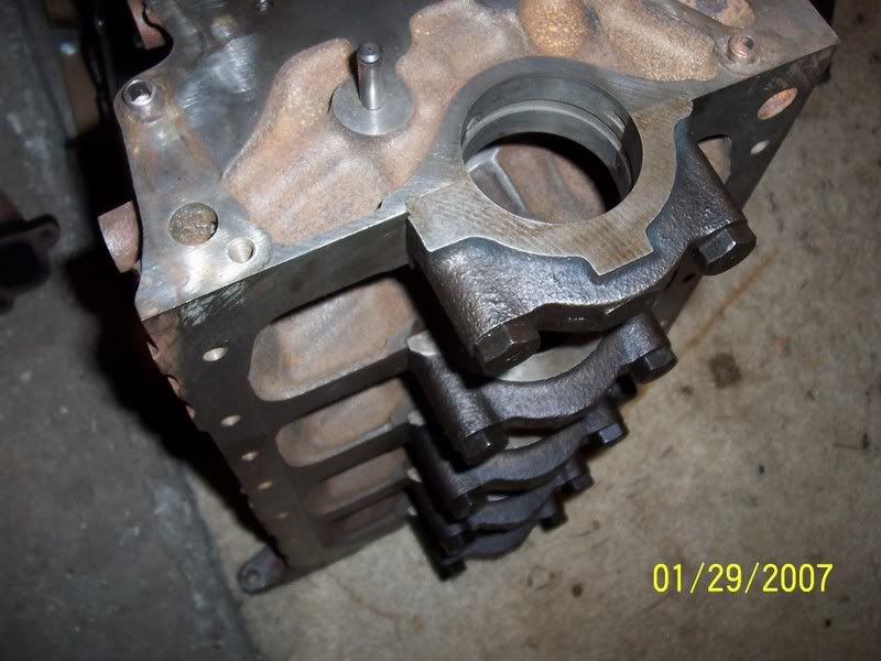

I received word from Ctmandu that the main caps are not available. I will have to use the main bearing caps from Tazman's engine, so that will mean a linebore is necessary to give the crankshaft a straight seat. Putting caps from another engine will work as long as the bore is perfect. I already checked the #3 cap and it isn't perfect. We want this done right.

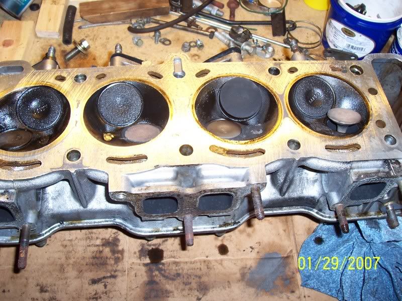

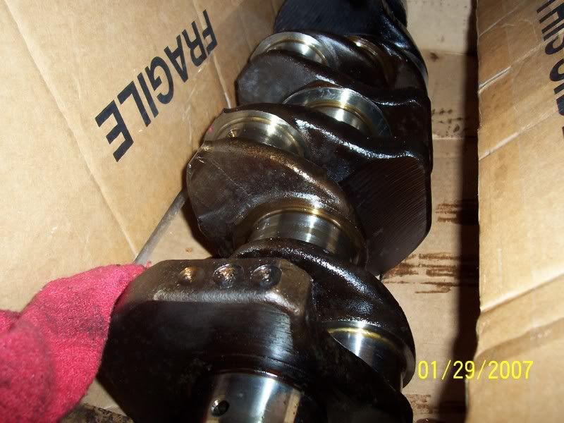

What a day! I got it all ready to head out to the machine shop tomorrow. I cleaned the main caps from Tazman's engine. I wire-brushed the tops of the caps and used a nylon scouring pad to clean the sides and the insides of the caps. I put the caps on Catman's block. I removed the crank from Tazman's engine, and cleaned the rods and removed the old rings. I found another broken top ring on piston #3. I am going to replace the pistons and rings. I cleaned the rods with the nylon pad. I removed the cylinder head from my engine. That's how you get ready to go to the machine shop!

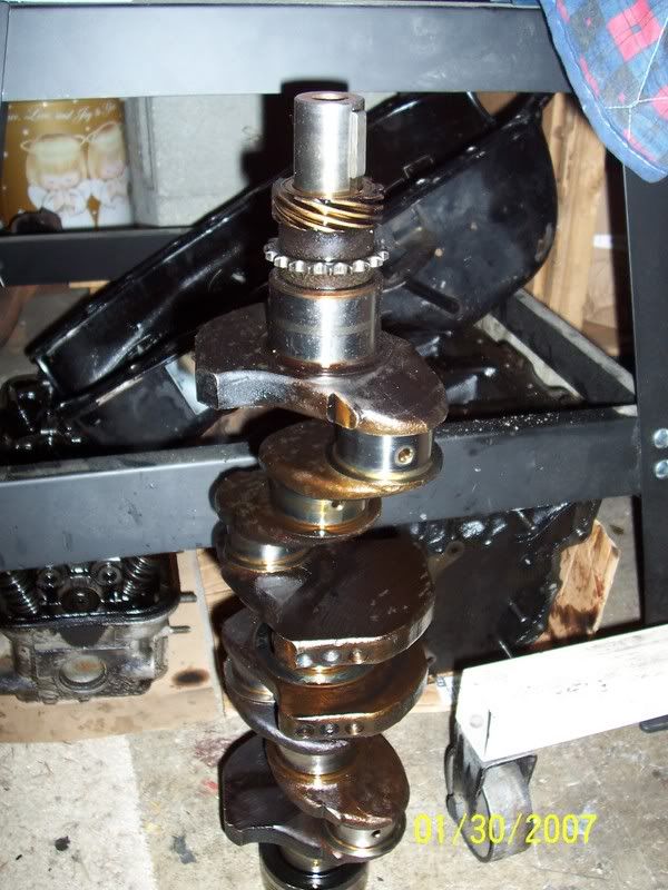

I had a little thought about that. I was going to call the machine shop and ask them, but now you've told me...thanks LuvrV8. I'm going to go do that now...

:? Just for your info i all ways was told to stand the crank up but then i thought about that and concluded that the person who come up with that idea said so because when you stand the crank up it takes up less room in the shop. Reasoning; When a crank is built/rebuilt an put in to a box they are layed flat,they are shipped laying flat,but laying a crank flat in a shop/garage is a good way to drop something on it,and i drove truck at UPS one winter and seen how they are handled. Standing a crank on end is a good thing but don't for get to tie it up cause when they fall over sometimes you end up with two cranks instead of one.I don't mean to rant but some times we do things people say to do but never check the reasoning behind it.Luvrv8 is right in the sense that standing your crank up in you shop is the best way to stop any possible damage to it. I think i have said enough and i will probably get a bunch of flack for it but sometimes we need to know the reasoning behind what we do. TA-TA :wink:

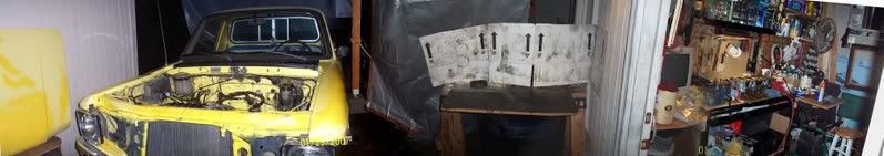

Ah. So then there's no harm done, right? I stood it up already but when I did I had a thought about laying down the law when the family wakes up and saying, "If anybody goes in the shop, don't knock the crank over, or..." I think tying it up would be a better thing, but then maybe I'll put it back in the box. It's going to be on the way to the machine shop in three hours.
The first photo may look a little funny because it's three photos put together.

I had that thought too. The key was my thought. I didn't think about the gears, and they look like they need to be pressed off. I'm not worried about the shop losing the parts. They are a 3-person shop, and they know what to do after being in business since 1960. Thanks for the heads up, 74-MIKADO, and that will be on the list of questions to ask about when I go in today.

When cranks are shipped they should be packaged so that the weight is carried on the main journals. I have worked for a few high line dealers and Mitsu and they are always shipped that way. Also when I order a LA Billet or SCAT crank for the sprint car they are shipped that way and a tag noting to not lat it down. It is your call, I only play with 900 HP Donovan all alum chevy small blocks, what do I know?

You are absolutely right and now that you've said that, I can more clearly remember when I was in SSCC heavy equipment mechanic school having been instructed to do the same. I remember seeing the cranks sitting on wooden forms that supported the main shaft line. You don't need more respect from me; you have it all already. It's still standing up. I hope there's no harm done to the crank for it being in the box overnight.

The top end crank are shipped like they should be but a flat 4 crank won't go south lay flat is what i meant and didn't i say i would get flack for this ,oh well thats what opinions are for,And no it is not good to use the main caps off another engine without line boring and if the machine shop that fullaluv is going to doesn't have a line boring setup he needs to find another shop.But here is a kicker maybe the machining on the Izuzu block is allot better then the american blocks(not) but if is reasonably close you could get by and probably have.

I don't see where you should encounter any problems with caps off another engine as long as it is line bored. You are going to line bore it i hope. Aren't you? As tj said you might get by without line boring but i sure would not chance it. Just my .02 worth.

The main bearing caps from the original engine should always be used when you can. Many times a engine mfgr. will build thousands of blocks on 1 runs and they all will be machined the same, so if you happen to get the caps from the same run you will be O.K. I have seen many engines built with different caps and vary rarely do I see them fail, it is not advisable but is done daily. I would say if you are not building a high performance engine chances are it will hold. If there is a problem it would show up in the first 500 miles in the form of low oil pressure and alot of bearing debris in the oil. I am not the final expert on this but I have built many engines and worked my way through trade school (Arizona Automotive Institute) by working in a engine machine shop and now play with sprint car motors.

Troy you're not in trouble. I got some flack from the machine shop over the phone today about the main caps. I didn't get the ride today, so time is going by. I told Kathy that the caps were swapped and she said, "Oh, you can't do that". Well I told her they were a very close fit and she said they would take a look at them. I think they will work, and yes this shop has a line bore machine. They are going to determine if a line bore will be successful before they actually do it, so if they do the line bore I should be okay.

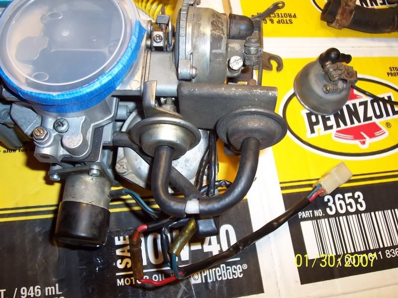

I put the electric choke on the carburetor today. It was interesting that the plate with diaphram B was not on my carb at all, even though the electric choke housing was. Was that what you were looking at when we pulled off the air cleaner, Troy?
I took a few photos of the carb after I finished the installation of the diaphram and the good housing. I also made some adjustments to the linkage.
