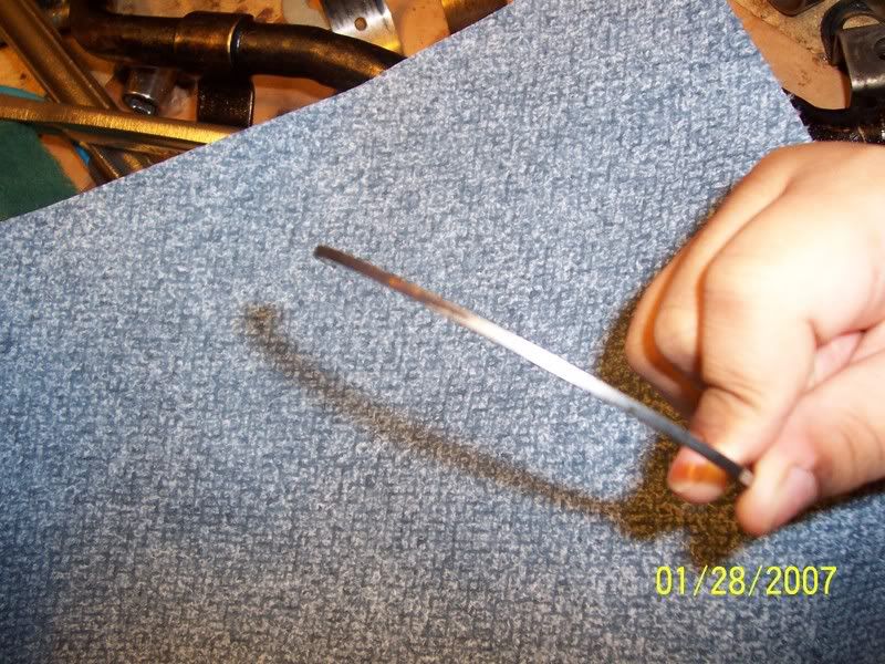

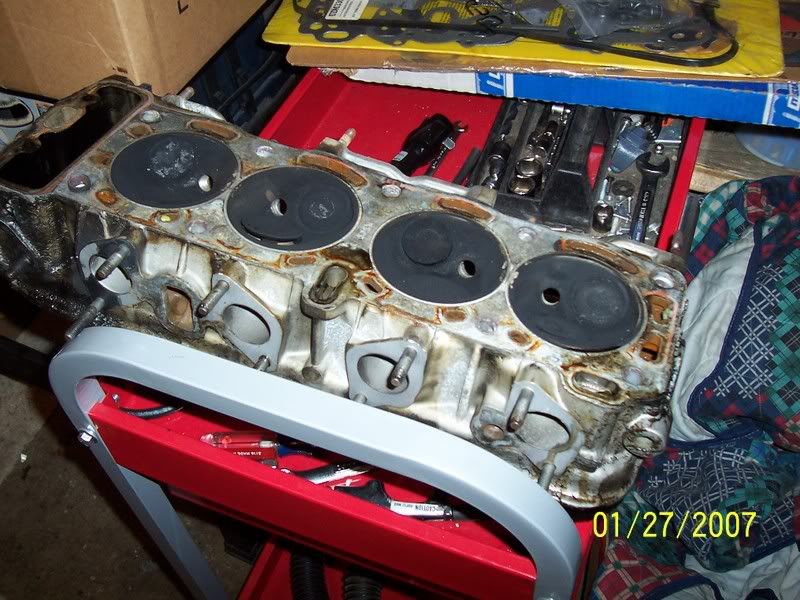

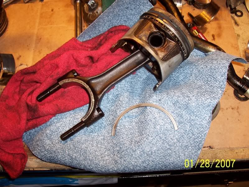

Looking at things today a little better brings me to conclude that the engine I got from Tazman would not have been a good candidate for use in the LUV for three reasons.
1) The block is cracked
2) The camshaft is broken
3) The #2 piston's top ring was broken

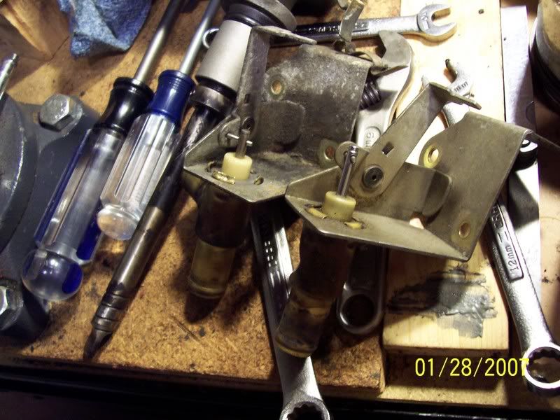

However, the crankshaft (see photo above) looks good, and might only need polishing. The piston rods look good, too. The engine was very clean inside and had no rust. I also have photos of the hot/cold valve and the electric thermostat from Catman. Also I noticed that even though Catman's block has been honed, it still needs to be bored, as there is a noticeable ridge at the top of some cylinders. The digital calipers indicate the bore is standard, so boring it out to fit either 020" or 030" oversize pistons should be perfect. I also didn't get the main bearing caps that should have come with the block, so that will require a line bore which will be $130.00, after I use the main caps from Tazman's engine. I will need the block surfaced, $70. Magnafluxing the block is $25, removing the pistons and pressing in the pins for the new pistons is $30.00. Having the measurements done will add another $10. Pistons look to be about $70, and rings another $70.
It looks like with my engine head, Tazman's crankshaft and rods, Catman's block, and some new pistons and rings from BlackLuv, we'll get it going good.

Fullaluv, If the cylinders clean up, it may not need boring unless the wear in the cylinders is out of spec. The ridge is at the top is common to used engines and can be removed if the bore is not out of spec.
PostPosted: Sun Jan 28, 2007 8:04 pm
Posts: 1075
Location: Covington, WA
It is out-of-round. The photo of my son holding the broken ring half is not a reflection...it was actually dark where the ring was not touching. The side to side wear is greater than the front to back. I will be giving the machine shop the last word on the block, as well as the head, the crank, the rods, and the pistons so it should all work out.
