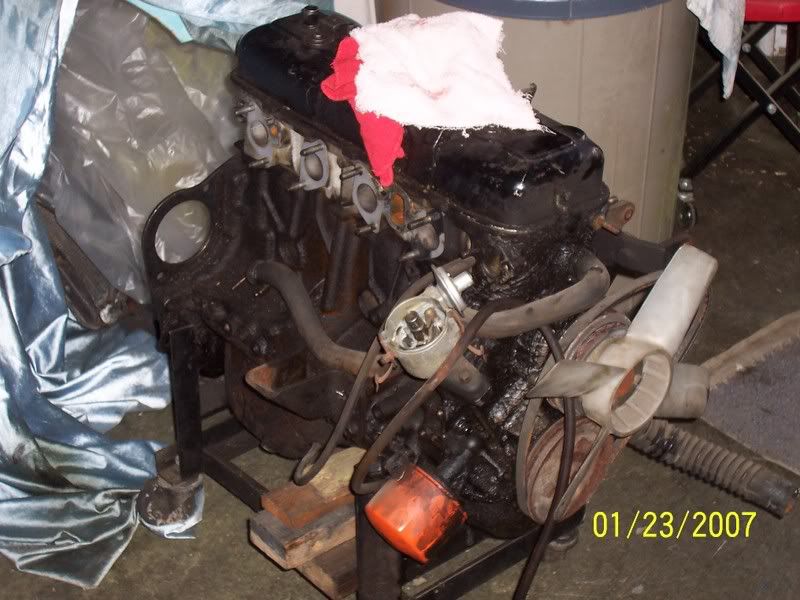

I made it down to meet Taz and he was a great person. His shop is real nice, and lots to see. He also has a nice LUV. He had the engine and I brought it home, also with all the gaskets and a new oil filter. I had a little trouble getting it in my little shop, but Larry and I got it in and I tried to get it on the engine stand but I didn't make it. I picked it up and put it on a chair later after Larry left, and then tried to go to the engine stand, but it didn't work. I couldn't get the bolts through enough and the bolts broke off the back of the block. The engine went down and good thing was we had the wood that Taz had given us to support the engine on the trip underneath. I don't think it hurt anything seriously and I decided to quit until later when I get a cherry picker. So here I am still trying and will try some more. I'm kinda worn out and ready to retire for the evening, so I'll just leave you with a photo of Taz's LUV.

It would be a lot easier just to set both of the engines on wooden blocks to swap all of the parts (except for the oil pan) instead of using an engine stand.
I never have been too crazy about using one unless it's for a rebuild....because they are just too darn easy to tip over...and IMHO they are usually more trouble than they are worth.
That's why I have my little four wheeled engine cart I made...it's a lot easier to use.
Once you use a hoist to pull your old engine and get it out sitting next to the one you got from me...it'll all go pretty fast.
Just take your time and be carefull...and if you get stuck just ask one of us...but never guess if you don't know for sure.

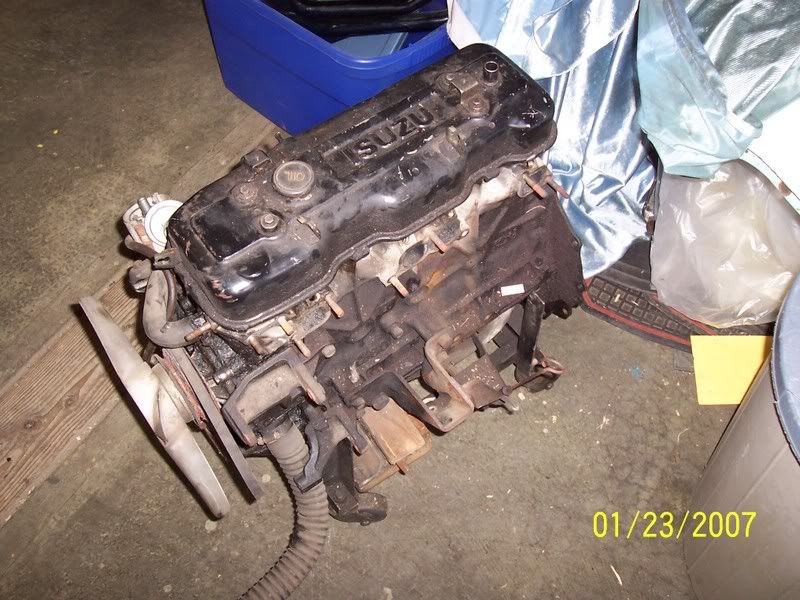

It's almost 5 AM and I am up and at 'em. I got some cleaning to do on the engine and Taz said to use paint thinner, so I'm going to try that. I also have a can of brake cleaner. Here's a photo of the engine still in Taz's shop.

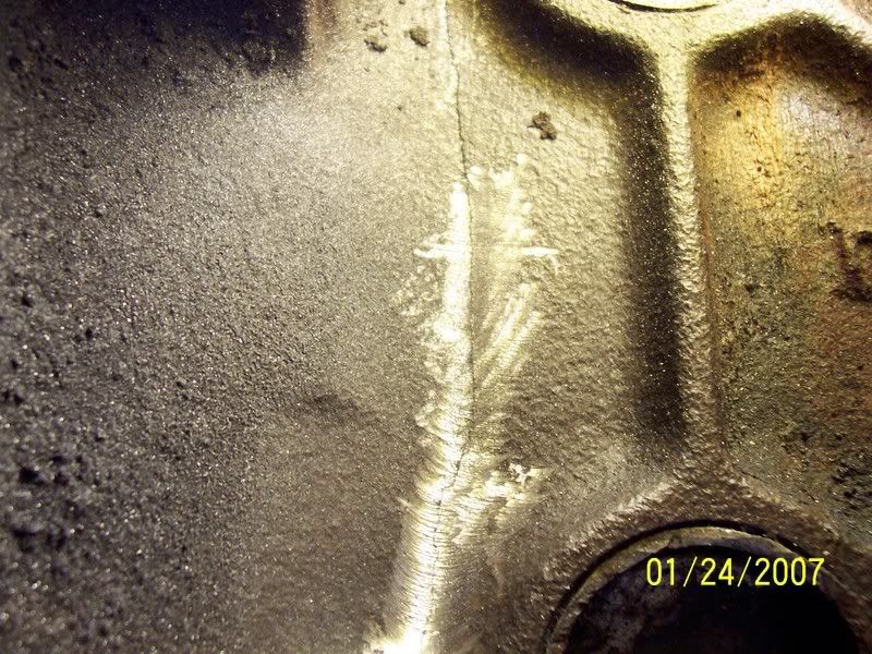

I examined the engine today that I got from Tazman, and I found the crankshaft and bearings to be in pretty good condition. However the block showed some rust signs, and upon closer inspection, i.e. a wire brush and a Dremel® tool, I found the block has a crack. I can't use it. The block in mine will have to have a lot of work on it to be usable, so it looks like it's bleak right now. I spent more money on the LUV than the donations covered, and my wife and son want me to get our minivan going. I wanted to get the LUV going, but it has turned into a bottomless money pit. I can't keep going and that's just the way it is. I appreciate all the hoopla raised on this issue, but unless I get another engine in good running condition without a cracked block, I can't afford to do all the work and put this together only to have it fail again. My present block is not cracked, but the machine shop wants about $1300 to do the block work and pistons, then reassemble the engine. They were trying to advise me of my dangers, but I thought I could do it on my own, so I tried. I can't use this second block, and I can't use my block unless I get a lot more help, and I also don't expect so much help, so I'm out of options here. I tried to get Tazman today, but he must be out in the woodshed getting his just due, so I'm letting everybody know here, and that's all.

Are you sure that is not a casting mark.

Looks like a crack here - you can see that he ground into the the crack with the dremel tool to verify. It looks pretty deep.

That's what I hoped it was, and that's why the grinding with the Dremel®. If you click on the photo you can see clearly there is a crack. Maybe there's another trip in the works. Also the gasket set is wrong. The yellow one, I mean.

Admittedly I'm not an engine expert but is that a structrually significant crack? Does it leak oil? If not, does it matter? It was running when Taz removed it from the previous truck so unless that crack materialized during the move I would suggest living with it.
What would be the cost involved with just swapping parts from John's engine to Taz's engine? Just labor, right? Maybe some incidentals?
I sure wouldn't pay to have a rebuild done on a cracked block (although I have in the past... :oops: ), but I sure wouldn't be above swapping engine peripherals to this engine. Heck, I wouldn't have even taken the bearings loose so long as it turned over.
In summary, my opinion is to put it together and drop it in? Am I all wet?
