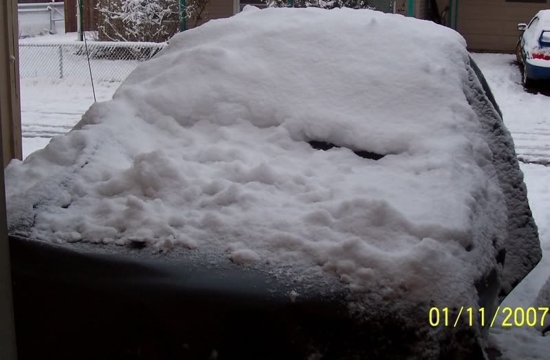

That's a fact about the 30W. I thought I'd ignore that and just go ahead with a small breakin. BlackLuv said that too, in other words. Well what is broken now you think? I am covered in snow today, and staying inside. No working on the LUV today either.
