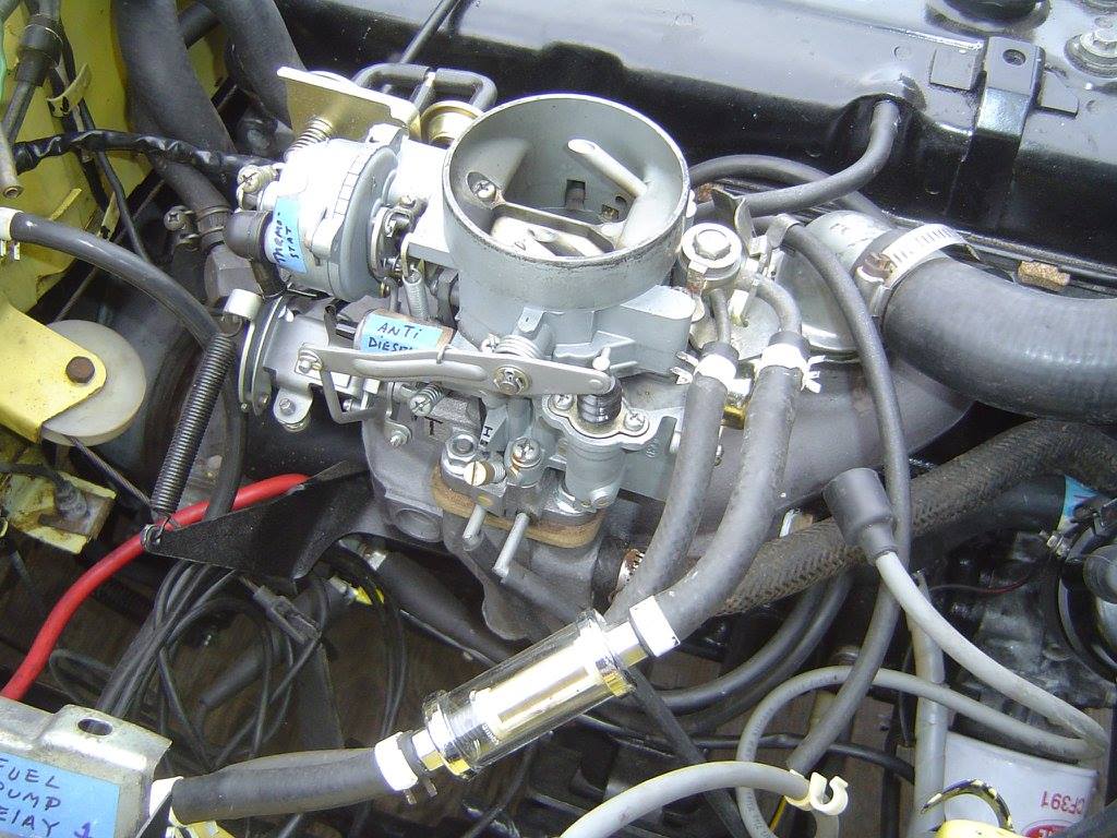

SkyyPayne wrote:
So. Pretty sure a buddy at work nailed it. He noticed the fuel pump wasn't coming on when the key was on. Found out it was only turning on when I was cranking
if the bypass the pump to pump gas and you have a problem (or fire from a broken glass filter) it will pump gas into a problem
its done that was for a safety reason....these truck really are wired in sequence......maybe check out the fuel relay
carb leaking yea check into rebuilding it, some areas for now but gaskets dry up and shrink which cause leaks maybe you can get away w/ tighten up for now
my fuel pump is only on when i crank the key to the far right too > Check the beginning of this video when i start mine up.
I also made a video yesterday showing my rubber connection i called it a " STOP N STUDY VIDEO " AS when you see a point of interest you can stop the video for clarity on certain line hook ups. sound isn't the best but video is mostly clear
I plan on getting ago pro for my video needs it will help w/ the sound
https://www.youtube.com/watch?v=AkXUGaFDqjk
& my idle screw marked " I " was just under 2 1/2 turns out
https://www.facebook.com/My1977IsuzuChe ... =3&theater

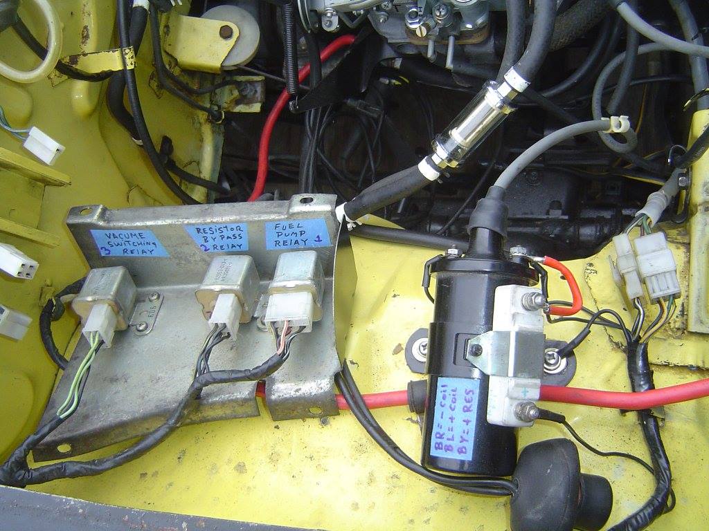

stock wiring order is important as rewiring certain things, like the fuel pump &or by passing the relay to a constant on/hot w/ the key, a different way well it doesn't complete the 1-2-3 order of how things work on these trucks.
when the motor stops/dies so does the fuel pump so it doesn't keep pumping fuel as if in an accident and line broke it could pump gas on a hot engine to start a fire...stock fuel pressure is also at a low psi
as far as the radio goes i always leave them out/off till i work the bugs out of the running gear in the vehicle so i can hear them.
i would stay focused on 1 area at a time it makes it easier to trouble shoot
double-check fluids 1st (2bsafe) on that other noise you hear. You can use a large long screwdriver to help find noise sources, place near noise on motor while listen to the handle.
here's those 3 relays labeled

Ah I was imagining left side from the driver seat not the front of the truck.
3rdLUV nice work on the labeling that will definitely save some people a lot of headaches
And Chris if that relay was bypassed and the pump is getting power along another line that relay may be getting back fed power and buzzing. I had one I added in that jeep power center I added to my truck. I had it wired wrong and it would make a constant buzzing/high frequency sound because it was being fed power the wrong way, and when the truck was off it would continue to get power and kill my battery. Was an easy fix but it cost me a battery after about a dozen times going dead sitting.
Hopefully we can find something next time you are free
