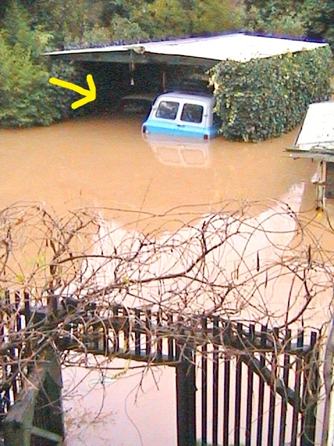

Thanks Jacobbarnes1 I will check that out as well .....I'm planning on tee back flushing the radiator, heater core and pull
the unit out as when i rescued this LUV from a creek flood & when reworking the rest of the truck i think i skipped
attention this area as it was summer.....peace
