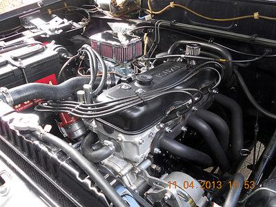

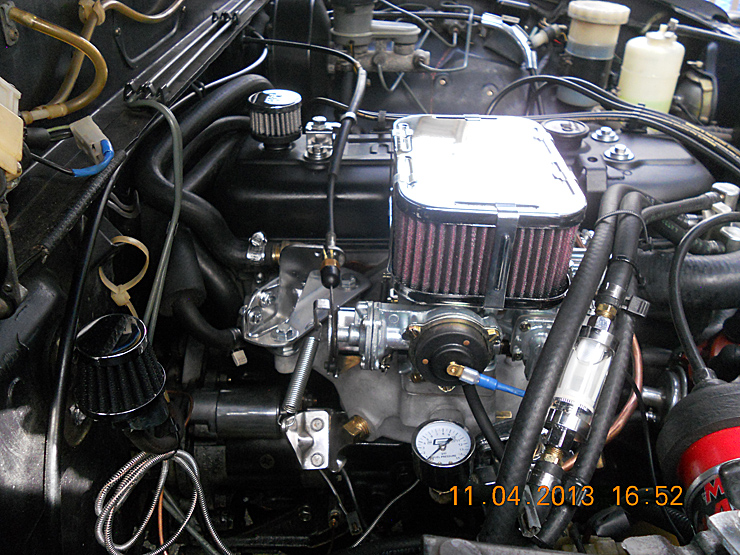

FINALLY ALL IS WELL!
HEADER, WEBER, OFFY NEW HEAD AND A FEW OTHER IMPROVEMENTS
FINALLY GOT THE BUGS (SHOP GREMLINS) RUN OFF.
I WILL HAVE TO SAY THAT THIS PROJECT HAS BEEN A REAL LEARNING EXPERIENCE. NO MATTER WHAT ANY ONE SAYS, WHEN REPLACING THE HEAD AND OR GASKET, IF THE HEAD HAS BEEN REMOVED BEFORE, INSTALL WITH NEW HEAD BOLTS AFTER YOU HAVE CHASED/CLEANED TAPPED THE THREADS. IF NOTHING ELSE, DO IT FOR PEACE OF MIND.
TRUCK RUNS SMOOTH WITH GOOD OIL PRESSURE AND EXCELLENT OPERATING TEMP. (170)
I WAS WORRIED ABOUT ALL THE COOLANT THAT ENTERED THE ENGINE ( RUNNING ONLY ABOUT THREE MINUTES) AFTER 5 GAL OF KEROSENE AND 4 GALS OF ENGINE OIL AND A COUPLE OF FILTERS, THERE IS ABSOLUTELY NO SIGN.
I AM DEFINITELY READY FOR A BREAK FROM TURNING WRENCHES
NEXT IS A LITTLE BODY WORK
I DO APPRECIATE ALL THE HELP AND ADVICE
I AM WORKING ON A SIMPLE PICTORIAL BUILD LOG FOR THE OFFENHAUSER INTAKE, WEBER CARB AND PACESETTER HEADER INSTALL. I DID RUN INTO SOME INTERESTING ISSUES WITH ALL THREE
THANKS
BILL
