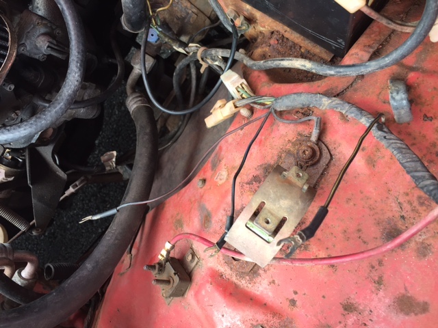

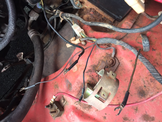

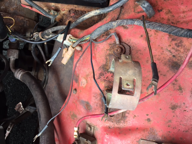

Hello could someone that has done the Pertronix electronic ignition conversion with coil (no resistor) please help me out. I took my distributor to a auto electronics shop, he installed the parts had me look at the unit functioning while on his tester machine, it worked fine as I could see the spark as he rotated the distributor gear so half my battle is over now that I know it is functioning properly. Now I have a wiring issues and need some visual help with. Before I took out the distributor, old coil and resistor, I took extensive close up pictures of the parts and wiring so I could refer back to them during the reinstall but unfortunately the phone that I used to take the pictures was stollen so now that I want to reinstall I have zero pictures to help me out and since it has been over 8 months since I started I can't even begin to remember what wire goes where, I wish I had also marked the wires but stupid me I didn't. Would someone please post a few pictures of your coil and distributor with a visual of where the hooked up wires are please. Im totally not a electronics guy at all so the more detailed pictures the better, pictures for super greenhorns. I have a total of 4 wires in the general area, first one closest to the passenger fender well is coming out of the wiring bundle case and is black/yellow stripe the next two are coming out of the same wire bundle casing but about 6 inches further down, one is black/blue stripe and the other is black/red stripe, the last one is further down on the same wire bundle but passes through a white plastic electrical connector before it comes out in the bundle and its also Black/red stripe. Lastly, what is the red wire that comes off the positive battery terminal wire bundle and connects too a small rectangle 2 prong screw box on the fender, the second prong connector has nothing attached too it, this red wire is visible in my pictures. Could someone please tell me which wire go where and explain it too me as if I'm a total nob, in this situation I totally am so no worries. Thanks in advance, the help will be greatly appreciated.These pictures are of the engine bay taken from the passenger side front fender, the distributor and coil are not in the picture nor are any wires from them.

I'm trying too figure out which wire I have pictured is my ignition power, non of the ones I have pictured have power with key on or off, only the little square 2 pole box with the red wire coming from the battery mounted on the fender( see it in the picture) has power with key on or off.

3 wires in play here. Black with red tracer goes to coil negative. Black with blue tracer foes to coil positive, this comes from the relay supplying power while cranking. Black with yellow tracer is key on power, it goes to the ballast resistor, another wire from the other side of the resistor goes to the positive side of the coil. This is the stock set up, don't ask me for pictures because the only stock I own is a lawn mower.

That Blk/yellow was the wire I needed for power from ignition. The Pertronix with coil is just a positive negative hook up with the Blk/yellow ignition wire you told me, I hooked it up and it runs! Thank you
