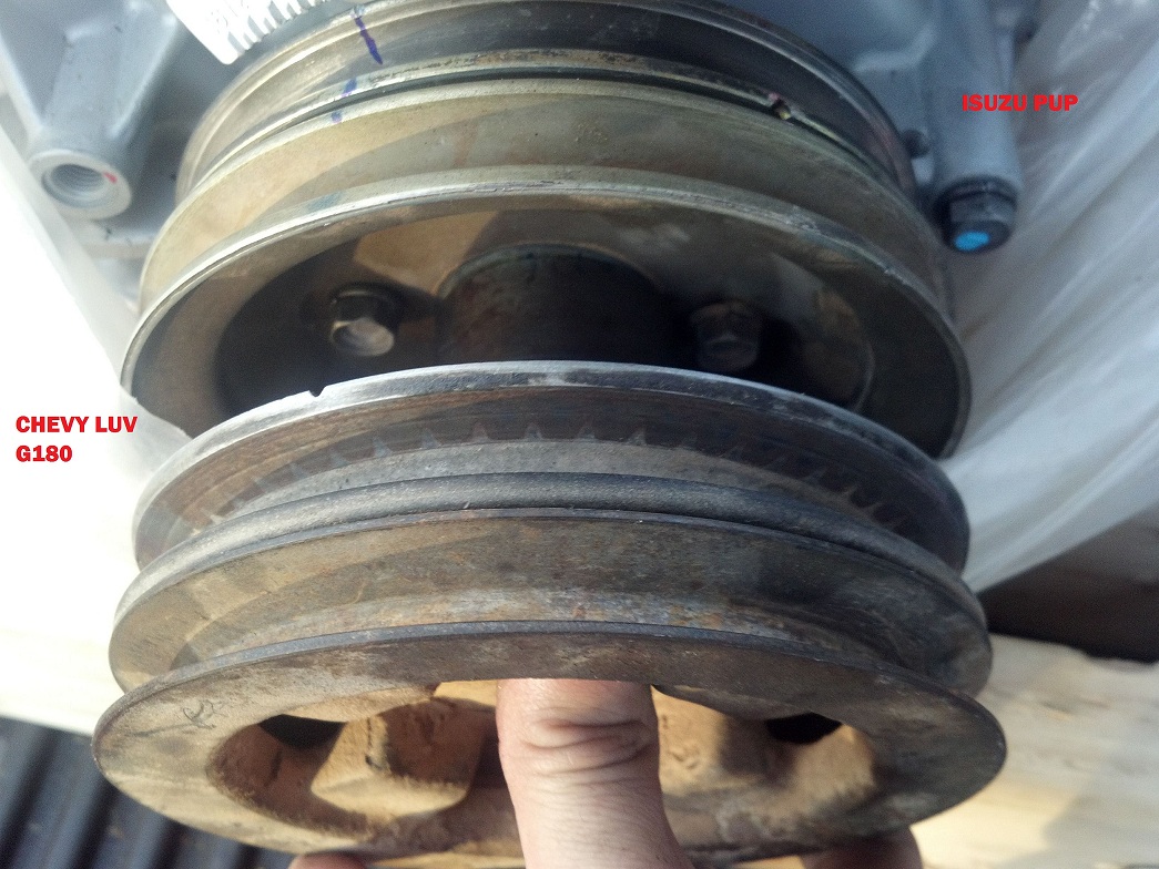

Small update
I received the other engine and checked the timing marks before I put the engine on the truck. I did as you guys said and placed the crank mark (harmonic balancer) on 0 TDC, checked the cam marks and they were off!! :evil: I couldn't believe my luck. The timing marks on the cam were at the exact same spot as the other engine. A buddy of mine who works for Toyota checked out the engine, we made sure the chain was correct, which it was, and he told me to check the harmonic balancer. Went to the junk yard, got one from a 1980 luv G180, which the balancer is smaller in overall diameter (5 1/2") placed it over the isuzu pup balancer (aligning the keys) and........wait for it......... the notch on the balancer lines up with 0 TDC and cam marks line up. Instead of removing the balancer from the isuzu pup and risking ruining the seal, I marked a groove on the balancer and will be using that to time it.
I hope to get the engine in the truck soon and have it running and hoping for the best :lol:
Marcos
P.S. - I measured the pup's balancer and the overall diam is 5 3/4" and the luv's is 5 1/2"
Im guessing the engine builder used a luv balancer to time the engine.
