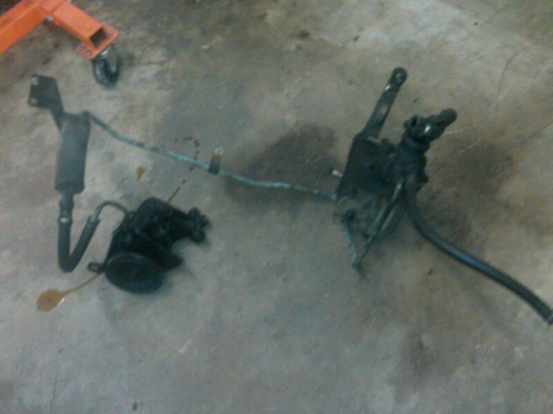

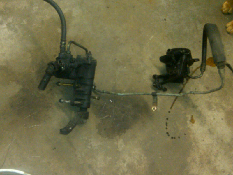

Ok, I removed all of the power steering stuff from my 1986 Trooper with a 2.3 engine.
The box, pitman arm, adapter collar, resevoir, and pump looks ok but I have a funny feeling the rest of the parts I have differ from the parts shown in the above photos. The presure line on mine has a long steel tube that runs from the pump down to the lower rad support, then accross the front of the engine and up to the box. The steel tube portion of the pressure hose is like 2 feet long! Does this sound right? Also, my Trooper donor truck was missing the smog pump, two of the brackets were still there and I pulled them, will the smog brackets from my original 1.8 work for the swap or do I need to use the Trooper brackets?
Next question, do I need the Trooper crank and fan pullies or will all align ok with my Luv 1.8 pullies?
Do you have the model year or Toyota part# for the rag joint?

Here is what I pulled off of the 86 2.3 Trooper engine. See that long steel line between the pump and the steering box? Is that the style you guys show? I don't see that part in your pics.

Kinda looks like to me you just need to use that existing line or after you get things mounted the way you want just fab a new one the lenght and route you need.

Maybe so but I am not seeing a good enough match with my parts to others I see here to even make an attempt yet, I'm wondering if there are two different styles and I have the wrong one? I have all the parts in degreaser right now, once all cleaned up I'll do some trial fitting.
