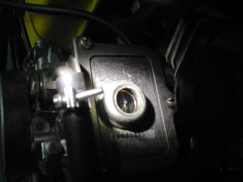

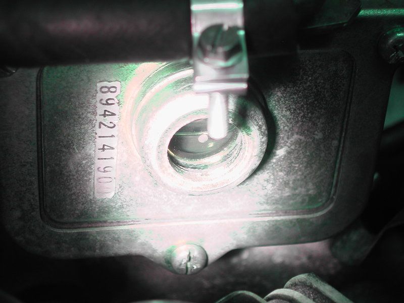

How do you adjust the choke at other than the middle mark. I put it there and that is the bench right. Now all the paperwork i can find says how to adjust the fast idle(thats like for cold starting) everytime i cold start, press the throttle to reset the fast idle cam and it lands well on the fastest setting. Is it s'posed to be adjusted further from this point. It seems like the choke is working fine cuz as it warms up it lands more and more open.
what is this thing for.
only pic i have of it. Its the little hex screw on the kick lever stop area. I don't see what it adjust except like the min rpms, but that's not the idle adjustment screw.
Right after the Dizzy install the mixture was way to lean and it was suffering, running at like 400 rpms. I did the book rpm adjust and then worked off of that to like 950 rpms at operating temp idle. It idles beautifully. the probs are accelerating it starts sounding like it misses and at cold starts.

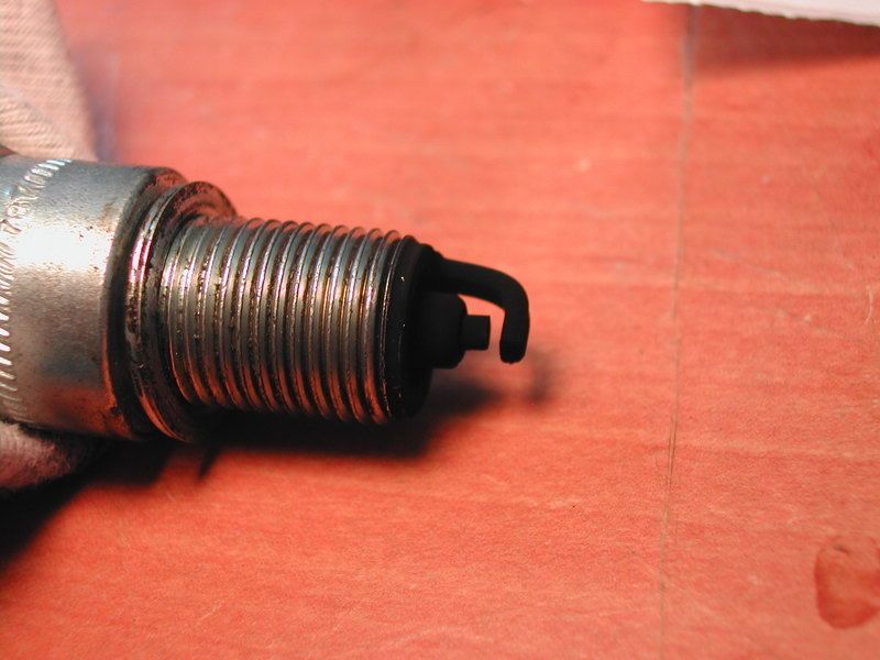

cleaned the Plugs and ran the engine again and they turned back to this
all four of them get like this
This is what my float is at too high. Should i lean it out.
I don't go to higher that 950 rpms for idle cuz at that point the jets start kicking in, i guess just because of the vacuum
At 900 - 950 only the idle jet is going

From the looks of those, I would say you were running a bit rich. Float level could be it, or do you know if anyone has ever messed with the jets?

The float bowl just supplies the fuel to the carb and doesn't regulate fuel delivery. The choke is electric, right? As long as it's got the hook on the lever, it should be opening the choke plate when it's warmed up. Is it?
The plug looks like a rich fuel mixture. Maybe the valves are needing adjusting. Have you done that? Careful there, if you do it wrong, you can cause bent valves and gouged pistons. You could already have a bent valve that isn't closing completely, and letting oil in the cylinder, but I wouldn't expect them all to be that way. Checking the valve clearance will require you to get a new top cover gasket set; if the gasket is old and worn it may leak.

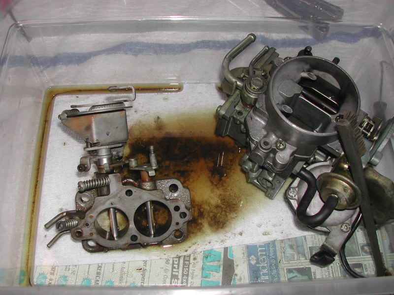

Ok here my 2cents did you rebuild the carb ?There are 2 plugs on the bottom of the carb for access to the main jets check to make sure the jets are in and in the right side. Next did you pull the air jets that are on top of the venturis if so make sure they are in the right side as the will interchange but wont run right. They are just the opposite of the main jets ie; small main and air jet on primary side and the large main and small air jet on the secondary side. Now if that is all correct pull the vac. off the dist. and adj. the dist. until the engine is running at it's best then back up until you here it start to labor just a little tighten it down and check the timing you should be close. MAKE SURE YOU HAVE VENTURI VAC. TO THE DIST. That means no vac. at idle ( all though some will pull a little at idle ) now check your timing while running and rev the motor your timing should keep advancing if it starts to go back check your vac. source. Point there are three adv. to a dist. initial,mech.,and vac. and you check them in that order. If you are not to confused with all this i think you will be up and running shortly. I will stay tune to your progress good luck and may the force be with you :wink:

One of the problems with those old hitachi carbs is they were poorly made to begin with, since japanese cars weren't designed to last as long as we keep our cars. In japan, everyone turns in their cars for credit frequently to assist in the recycling of materials, since japan has to import almost all of the raw materials necessary to build a car.
The main parts that are still usable are primarily shipped out of the country for sale in foreign markets, the US being one of the biggest customers. We buy used crate engines, used transmissions, etc. in huge quantities. What is left is scrapped and recycled.
Any cheap old japanese carb, as it wears, begans to leak and suck air/fuel around all of it's moving parts due to excessive wear from inferior grade steel rubbing on poor quality aluminum, and also partly due to some pretty lousy casting and machine work when it was manufactured.
So trying to rebuild a crappy-made 30 year old japanese carb is a little like embarking on a never-ending quest...lol
