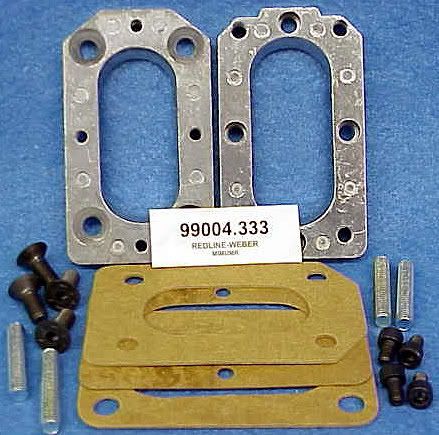

I found a place in Monterey, CA that has just the Weber adapters available, $33 plus shipping:
99004.333: Japanese two piece carb adapter.
Adapts DGV series Weber carbs to some Chevy Luv, Dodge Colt/Champ, Ford Courier, Isuzu, Mazda, Nissan, Suzuki & Toyota mainfolds. Manifold studs measure 3.150" x 1.740" (80mm x 44mm) center to center.
http://www.jameng.com/products/index.phtml?section=12

PostPosted: Wed May 16, 2007 9:06 pm
any one of these will work, the first one is what is on mine
http://www.jameng.com/products/images/99004.300.jpg
this would be the best
http://www.jameng.com/products/images/99004.250.jpg
and then there is the one you showed..
