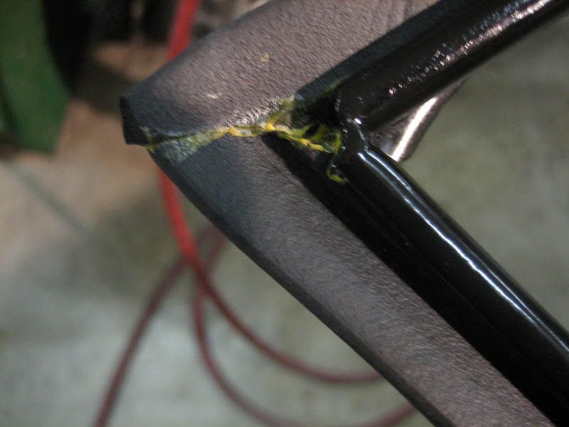

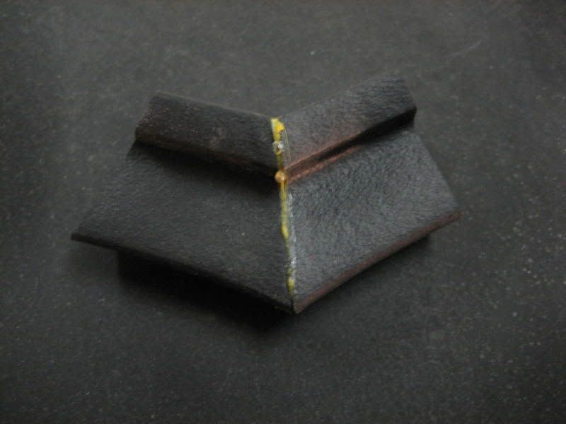

Test of new weatherstriping for the sharp 90 degree corner of the door

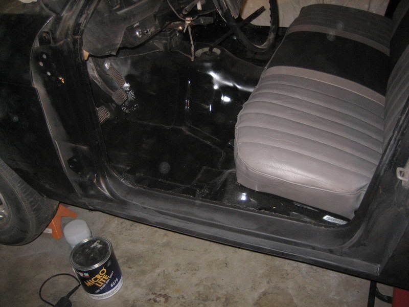

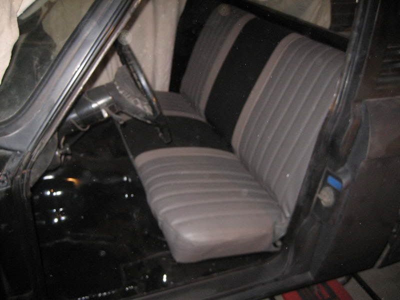

seat installed with floors all welded and painted. I think I need some carpet now

finished seat in the truck
corner on new weather strip my practice piece was a little better

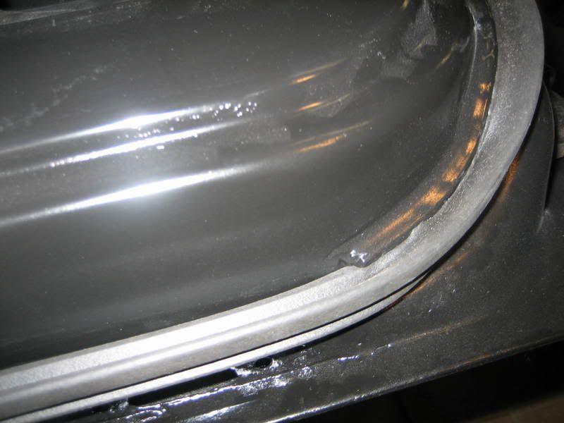

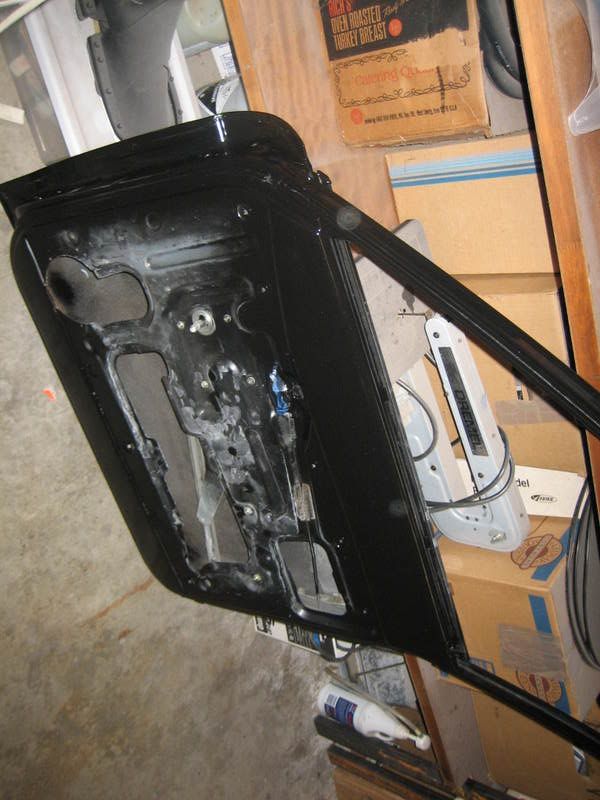

Inside of the doors were really bad so i did a little body work and repainted
Bottom of the doors looked like swiss cheese form rust holes. I ground away all the rust I could sealed everything i could with professional grade rutoleum then i filed the holes with the bond0 filled with fiber glass hair. the fiber glass hairs in the bondo really filled the holes great.

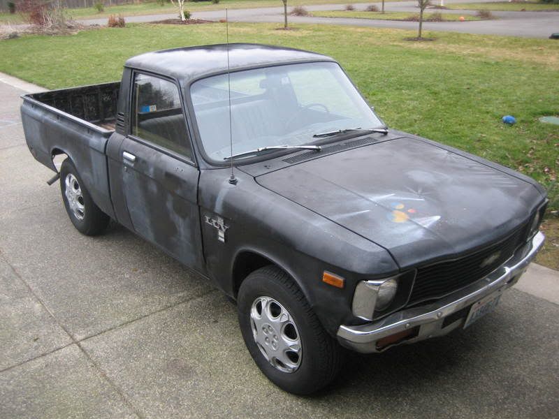

here is my 1976 luv I did in high school. I sold it in southern california in the summer of 1985. If you know where it is I would probably buy it back.

Here is my key learnings from the floor pans.
1. If you are going to try to do a continuous bead make sure you have 100% rust free metal all the way around. I ended up just tacking every couple of inches and then sean sealed it.
2. I would take some time and do some crude forming of the stamped rips. heating and beating with a hammer will do the trick. I just patched together flat pieces. putting a couple of ribs in will make it look better and stronger.
3. watch out for the fuel lines on the passenger side

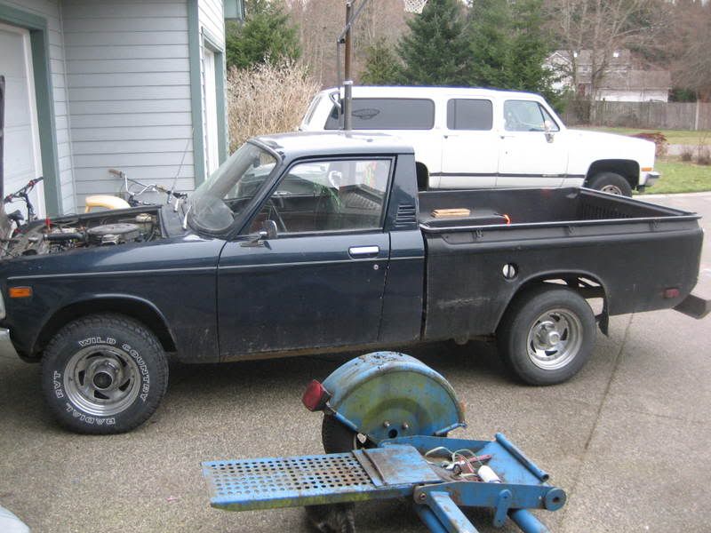

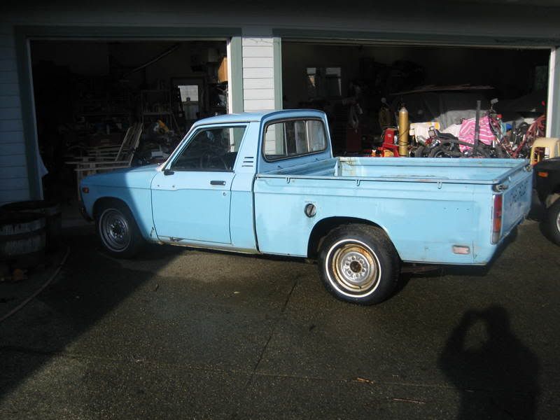

Quick Update
1980 black luv #1 is up and running. Lapped in new valve and she is running great
1980 Blue luv #2
Running with oil leak front crank seal, Electrical problem, Carb and fuel pump not getting any voltage
1980 Black and blue luv 4x4 #3
Blue cab, black bed Might have a blown engine. Not sure yet just got it Friday night. Took the wife on a hot date to pick it up and tow it home. I am so romantic. :D
