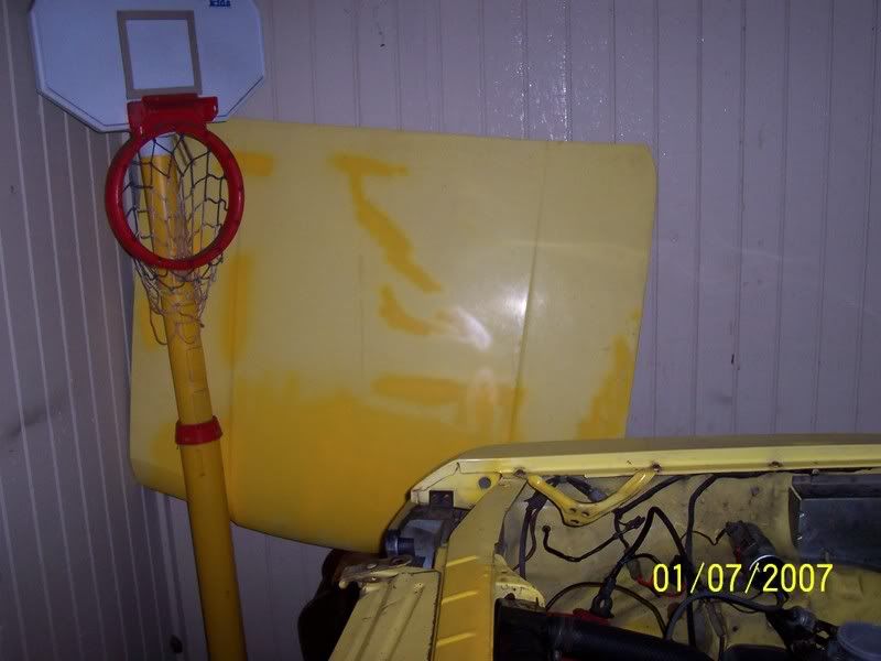

I had it sandblasted. :D
'78 1.8L 4-speed Fleetside
Image Image

looks awsome! i like the finish it left.
