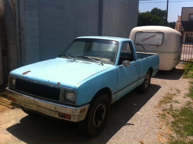

Thought I would tag along here.. I also have an overheating problem, with similar symptoms. My 1981 LUV truck runs at half temp around town and even idling in traffic when the weather is hot, the temp stays at half or even a little below. My issue is at highway speeds. Anything over 55 and the temp starts to rise. I have not gotten it all the way to H as i've already replaced the head gasket once and don't wish to do that again. It was overheating regularly before the gasket replace. At the time of R&R head gasket, I got a new t-stat. Flow into the heater core is good, it blows very hot. Both hoses leading into and out of the radiator are hot, and the t-stat is operating correctly, opening at 180 degrees, and I can tell the pump is also working, by flow in the radiator. I have flushed the system with the "vinegar technique", running the engine with vinegar in the cooling system to hopefully remove some scale or crusty bits in there, then flushed with hose water. It worked pretty well actually. I then flushed the entire system three more separate times with hose water, including the heater core, after running it pretty hard, and always filling up with Distilled when i'm done. My filling technique is to fill up to the level of the t-stat, install t-stat, then fill the rest of the way up from the radiator. The first couple flushes were pretty nasty but now the water stays mostly clear, although there is a light film of rust on everything. Oh and also I shot a laser temp gauge at the head when running at half-temp and the temp is 180 degrees, so the gauge is working correctly.
I use my truck for everything, and I plan to drive it cross-country hauling a small camper trailer, which it does barely. The trailer just makes the overheat issue that much worse, obviously, as the motor has to work harder. I love my truck, any thoughts and comments on my overheat issue or cross-country voyage are welcome.
