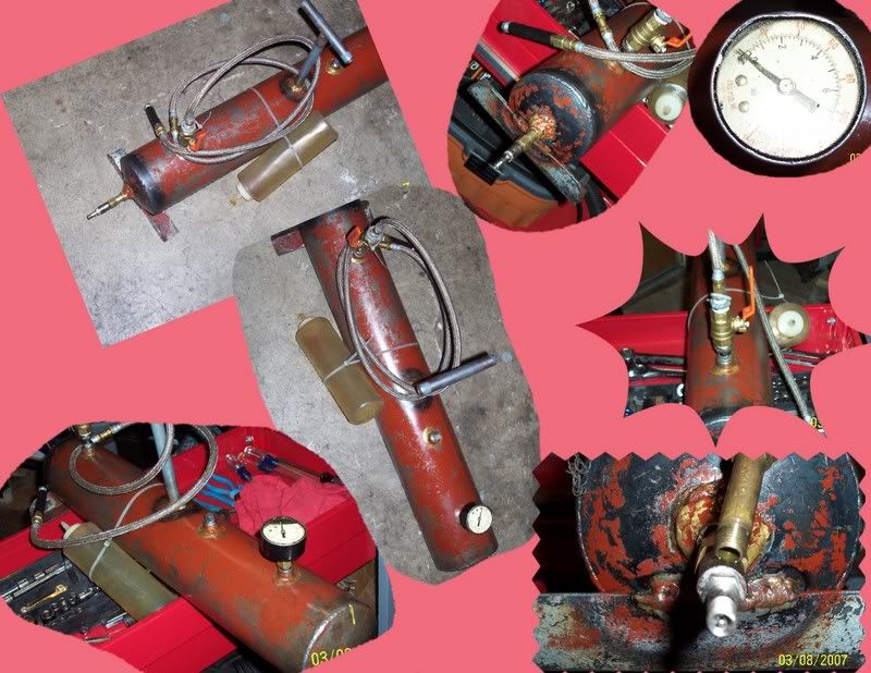

Here's the engine oil primer that Pacific Auto Machine loaned to me. Priming is all done.
This was made some years ago by one of the owner's of the machine shop. It fits the hole where the oil sensor goes. You put the engine oil right in to the tank, then fill the tank with air pressure. Slowly open the valve, and the oil will flow out the tube into the oil galley all the way to the rocker arms!
I haven't even installed the engine yet! I returned the primer today.

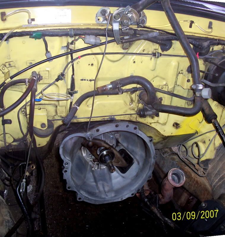

I did a bunch of prep work, but still haven't installed the engine! Notice the oil pressure gauge line waiting to be connected. I put a little blue tape on it to keep dirt out. This photo shows how I hung the tranny with a heavy wire from the hood-lock bracket. I needed to move the LUV back to have room to turn the engine hoist around. I sort of did a practice run today. It won't take very long now. Any time...

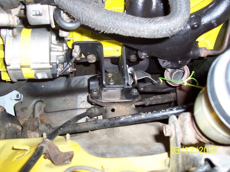

 Post subject: Engine's in!!!!
PostPosted: Mon Mar 12, 2007 11:50 pm
Posts: 1075
Location: Covington, WA

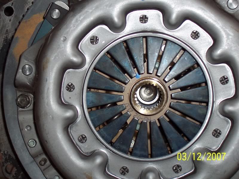

It was a sunny day today. kind of caught me off guard, but I noticed the sunshine outside, so I decided it was a good time to put Rumblebee in. I got it in, but there's still all the little things to do, and I haven't got the one we all want to see, the startup. Here though you can see the clutch assembly installed, and the motor mounts in. I don't want to post a photo of the whole engine until I get it all finished.

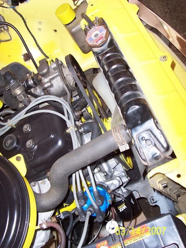

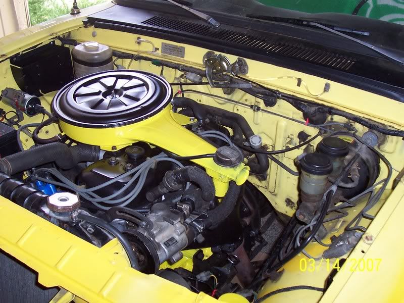

 Post subject: At last!!!
PostPosted: Wed Mar 14, 2007 5:40 pm
Posts: 1075

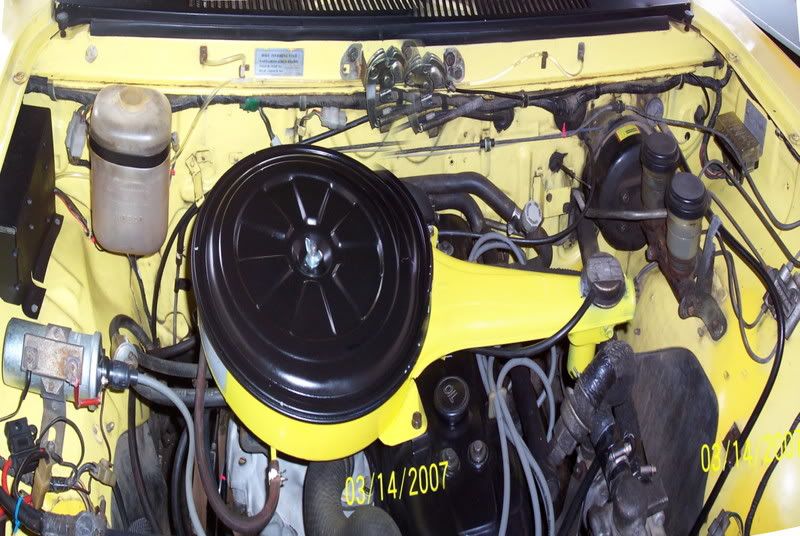

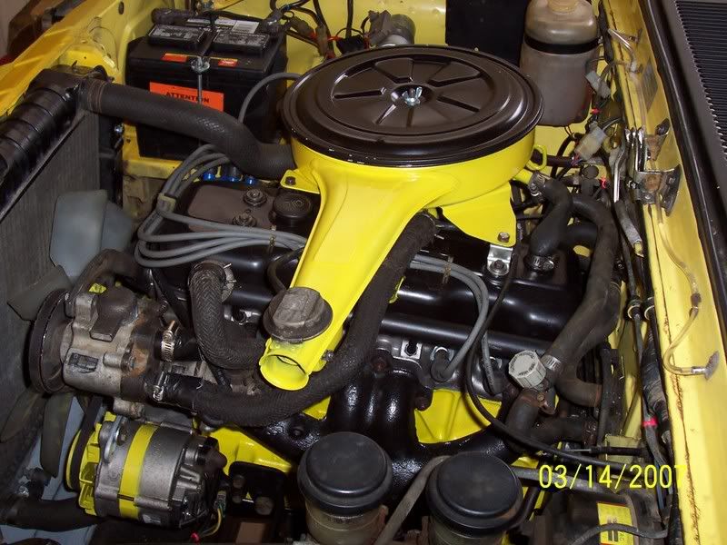

Here we go! I am ready to start the engine just as soon as I fill the coolant passages with water. I will be doing the first start at about 6PM. I will be recording it and posting that first start for all of you to enjoy. Here's some photos of RumbleBee and my LUV.
Thanks again for all the good advice and encouraging words, everybody. I am so happy the day is finally here.

Every hose, every part in place/Will it run?

I put a spray can cap on the coolant overflow tank!/Today is the startup.

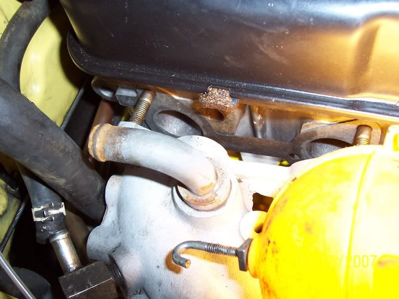

 Post subject: Uh Oh!!
PostPosted: Wed Mar 14, 2007 8:06 pm
Posts: 1075
I started putting the water in it, and the water began running out!! I seems I got the wrong gasket set given to me. I had already known the head gasket was wrong, but I thought the intake was right. Now I have a postponement to deal with, and I will. I will order a new intake manifold gasket, wipe up any water, and put it back together, checking to be sure no water entered the cylinders.
I have to remove the air cleaner, the carb, and the intake manifold. I will be doing the work in the engine compartment. Oh well, another day.
I never turned the engine over although I did check the GEN light.
At least there's no cleaning to do!!!!

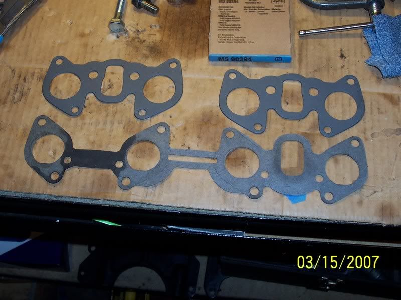

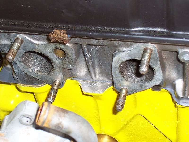

 Post subject: First Start
PostPosted: Fri Mar 16, 2007 10:20 am
Posts: 1075
I changed the gasket on the intake manifold, put RumbleBee back together, filled the coolant system with water, and went to start up for the first time.
There's no spark. Notice the timing light is not flashing in the video? My friend Jeff was helping. Fred had the key, and Lisa had the camera. Me, I just stood around and directed!
Gotta find out where the spark went... :)
