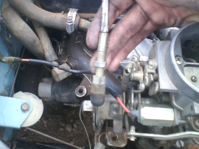

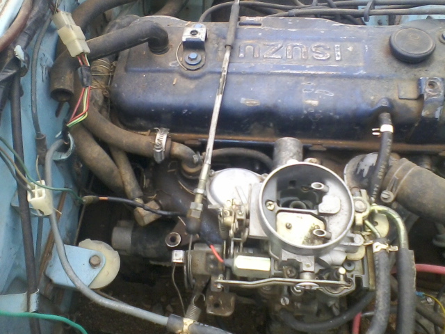

In the pictures attached is showing what is missing (no not the air cleaner and dish, I have that)
I need the piece that allows the throttle cable to work and makes idle possible (can't think of the name of it... Throttle cable bracket?) I might be able to rig something up but would prefer the right piece.
Does anyone have one or know where I can pick one up ? Auto Parts stores and RockAuto don't seem to have one.
If you have one, PM me a price + shipping to Southern Arizona, 85615. Paypal ready.
Could I also get a pic of one in its natural location so I know what I'm working with? (This is my first time on a LUV)

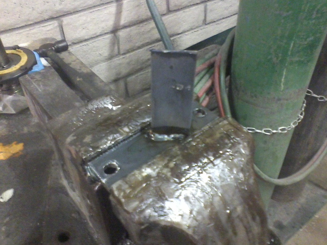

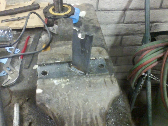

Something like this right?
Had some metal strap laying around so I threw something together. It was a quickie but it will do until I find the proper piece.
Still would be interested in the correct throttle cable bracket! Shipped to 85615!!!

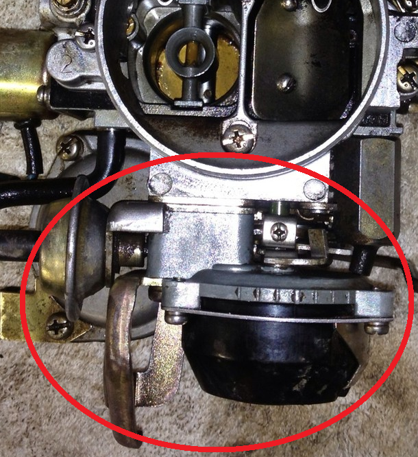

The bracket you are looking for is usually bolted to the carb itself, not the intake. Here is one pic I dug up on Google:
http://www.justanswer.com/uploads/rickr ... rb_006.jpg
It shows the bracket on the right that also holds a vac diaphragm that is part of the secondary linkage I believe. Looks like you are missing that too.
I also found a carb on ebay with somewhat decent pics:
http://www.ebay.com/itm/111093890042
One of the pics has a pretty clear view of the bracket and the vac part.
Keep in mind that the LUV carbs did change a little over the years. Some of the 76 and 77 carbs I have actually have a couple of vac diaphragms in that area instead of just one. Main point is though that you are missing more than just that bracket. I'm not sure if you are going to see the secondary open up at all on that carb or whether that missing part is more involved in the choke and not the secondary. No secondary working means that truck will have even less power than normal, which isn't a huge amount already.

Actually the missing diaphram is the choke pulloff unit. The large flat horizontal one is the one that operates the secondary. Pull off diaphram's job is to pull open the choke slightly when the engine starts to keep the mixture correct and not flood out the engine until it warms up.
Yes I remember now, thanks egg. I had one of them on my 76 split right down the middle and I JB welded it back together. As I recall before I got it repaired I backed the choke off a bit but it was starting and running ok without it, as long as the vac line leading to it is plugged. It is one of the very few things that the stock Hitachi carb tolerates being unhooked or disabled. :lol:

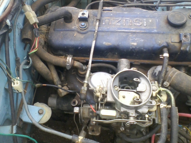

Oh okay, I see what is missing! I'm missing the entire choke pull off unit! The vacuum nipple that the hose attaches to has been capped off. I've looked all over the inside of the truck and in the bed and the part isn't there.
Attached are pictures.
So the name of what I need is the choke pull off unit ? Choke assembly?

Installed new starter and new fuel pump and put some gas in the tank...
She runs!! Fires right up with little effort too! Smokes a bit but I can smell bad gas so that's probably what is causing the smoke, on top of the truck has sat for who knows how long.
Without the choke assembly she revs really high so I have to hold the flap closed with my hand to keep it at idle, but won't rev without the proper linkage (which I guess is part of what is missing) to allow the flap to open when the throttle is pressed.

Sounds like some of the linkage is screwy to the fast idle or the idle is just set too high. You should be able to hold that choke wide open and get it to idle down to normal. Might be some of the parts of the choke and hanging loose and binding up the the throttle making it rev up. Does the throttle close itself when you manually pull it open? ( as if the cable were pulling it) There is usually a spring on the throttle shaft that turns it back to closed, but also one that hooks to the bracket that the cable hooks to that pulls it closed. One or the other will do, but if both are missing the throttle will sit open and rev high until you twist it closed again.
To adjust the idle there is a screw that is on part of the linkage right next to where the throttle shaft goes into the carb. Don't mess too much with the screw on the base of the carb on the side, that is the idle mixture adjustment. First make sure someone didn't just crank the idle screw up too high. That mixture adjustment is pretty fussy so before you touch it you want to have the rest of the carb working-ish.
I've had some trouble with the stock carbs like everyone else, but I could usually get them to run pretty much right without too much fight. I think I actually fought with my Weber more getting it dialed in just right. What you have though is more like parts of a carb and it may have left over bits of the missing pieces getting in the way of what is left.
