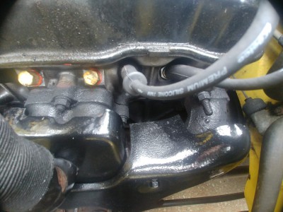

I had welder friend plug holes in tube fittings to fill holes. There was no clearance for anything else. Looks very clean. Happy with results.
