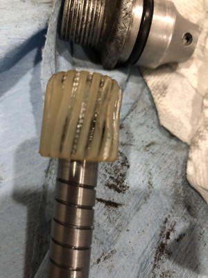

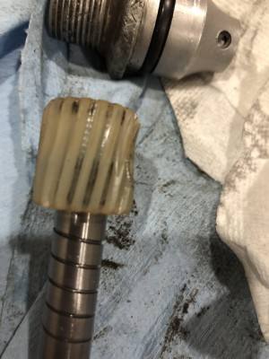

This is the first time I've pulled a speedometer gear. My speedometer hasn't worked since I bought the truck. The previous owner installed a digital speedometer and sender. It looked like transmission fluid is leaking from the speedometer sender so I thought it might have damaged it. I pulled the digital sender, hooked it up to a meter and spun it with a drill and it looks like it's still working. So next I pulled out the speedometer gear and noticed it's worn. My question is, do you think this amount of wear could stop it from spinning?

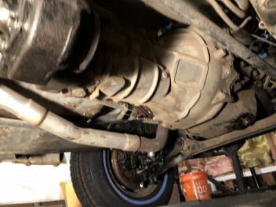

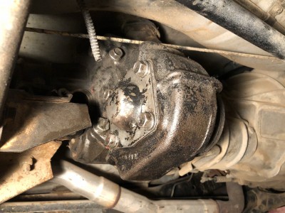

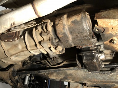

I can get you the factory part numbers but I highly doubt you will find them on the shelf anymore. Like I was hinting on Facebook you need to figure out that Trans you have, post pics of it to help us help you.

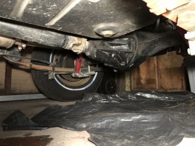

I have a 1972 truck with 72 rear end and suspension. A g180 motor was dropped in and it looks like a 4x4 transmission (it has a 4x4 transfer case and I can see where the 4x4 shifter would normally extend out. The 6x17 gear is just what I pulled out I have no idea if it's correct, I haven't had a working speedometer to look at accuracy (and transmission, gears is all new to me I'm trying to figure it out as I go). Do I need to find the specific model year for the transmission? I was poking thru the Haynes manual and master parts catalog and it looks like they're similar 9-12?
I'm a little confused which gear is correct I'm seeing conflicting info on forum/master parts list. Does my 72 rear axel change anything? i still have the stock rims and put a comparable sized tire to the original 27x8.50 R14LT that came on it (expensive!)

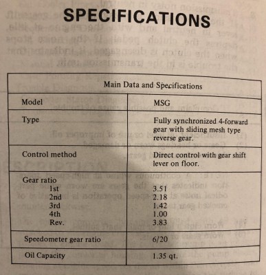

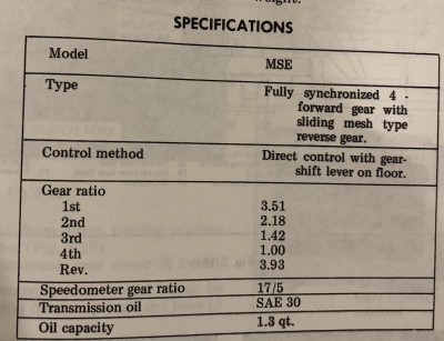

was thinking maybe the 1972 Gear drive was put in but I have the 72 and 76 shop manuals which call for 5x17 and 6x20 respectively.
Searching the forum someone else pulled a 6x17 drive gear from a 79 so I'm thinking previous owner just brought this one over with the transmission.
File comment: 1976 Gear drive from shop manual
File comment: 1972 Gear drive from shop manual

Jack- 6x17 driven gear was stock for a series 8-10 LUV with auto trans, which had 3.73 gears. Manual trans with 4.10 gears used a 6x20. When I went from stock 27"-28" tires to 31" tires I swapped in an auto trans 17-tooth gear to get my speedo back almost correct.
OP apparently has a 4x4 MSG tranny swapped in, which should have had a 6x20 speedo gear. Who knows why it has a 6x17, maybe to correct the speedo for a different tire size like I did?
Was the speedo correct with the 6x17 gear and the current tire size? If not was the speedo reading fast or slow? To read faster use a gear with fewer teeth, slower a gear with more teeth.
I have bought speedo gears from JLEMOND in the past, they were about $25 each, may be more now. They come in 16 through 20 teeth & maybe 15 & 21 tooth as well.
I think a '72 LUV had 4.56 gears & used about 26"-27" tires, which would account for the 5x17 speedo gear listed in the specs. I'm basing this on the fact that I have three MSG-5 Trooper trannies that have 5x15 speedo gears which corrected the speedo for 4.56 gears & 29" tires.

Thanks for the great information! Do you think the damage to my speedo gear would account for it not working? The Speedometer has never worked while I had the truck, been putting this fix off. I think at this point I will message JLEMOND and see if he still has anything for sale because I can't find anything on google/ebay/online currently.

The gear definitely needs replaced, whether that's the cause of the speedo failure- maybe.
I would see if it meshes with the drive gear in the tranny to make sure there isn't something wrong internally: separate the driven gear from the cable, insert into the tranny, then with the tranny in neutral & the rear wheels off the ground turn the driveshaft by hand, see if the end of the speedo gear at least tries to spin. It may try to turn a bit, then quit when the worn nylon teeth slip past the drive gear teeth. You may not can get sufficient speed turning the driveshaft by hand, if you must try idling the truck in gear, but use proper safety precautions. If the gear doesn't try to turn at all then a new gear might not fix the problem. If the gear tries to spin then I would replace with a new gear. If your truck has 4.56 gears and you tires are close to stock size listed on the door pillar I would first try a 6x17 gear, see how close the speedo reads. You can adjust the accuracy with both different speedo gears or different tire diameters. Remember, you can only get so close, & only for a short while: the speedo accuracy will change by as much as 4% as your tire tread wears.

When I got my 4x4 the speedometer didn't work. The truck came with a new cable so I put it on and still nothing. So I pulled the gear out and it looked like yours but way worse. The gear was seized in the housing. I got it freed up and took one from one of my parts trucks. Works great now.
