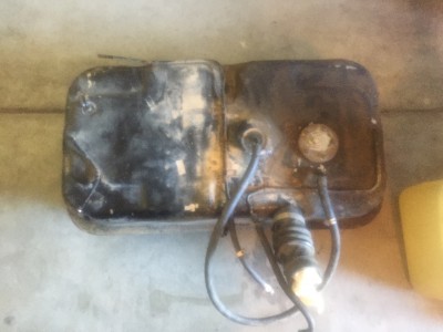

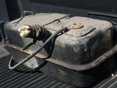

Thanks for the replies. I installed it this morning and put them side to side, physically they look the same. They also have the same hose connections, nothing different. I don’t know if they are somehow different on the inside.
The old one I took out, from what I could see inside the tank, had a metal line (main feed gas line) that has rot in different areas of the rod. The replacement tank’s rod/line was clean from rot or anything else.
The problem I was having with the old tank was, at about half a tank it would start to not be able to feed gas from the tank to the carb. I bought a new Mr Gasket electric fuel pump and fuel pressure regulator as I installed the rebuilt engine and were working properly.
I hope this was the problem and that this will fix it. After installing the tank I put gas in it and ran it. No problems for now. The sending unit works on and off showing about half a tank of gas which seems right.
Old tank, first picture below.

Replacement tank.
