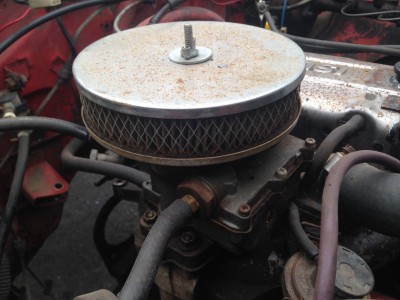

Does anyone have a suggestion for a replacement air intake assembly? Attached is a picture of my current set up. Is there a cheap assembly like the stock one?

Measure the OD of your current carb neck, search online for "air cleaner adapters", find one that will fit your carb on one end. The most common size for the air cleaner throat will 5-1/8", available in about any size, price & style you could want.
