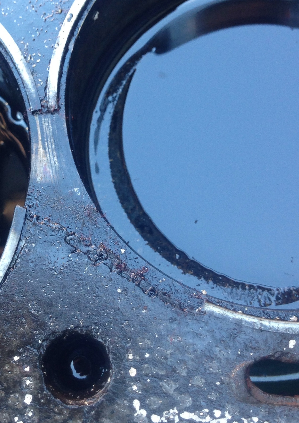

I tore down the motor today and it turns out that the gasket burned between 3 and 4 pretty badly. Put a new head Gasket on and it runs like a champ!

Holy crap how many inches through the floor were you holding your gas pedal when that happened? I have seen a carb gasket blow out that bad on a turbo motor never a head gasket.
At leaat it is a fairly cheap fix compared to a broken cam or shot valves

I honestly don't ever run the truck over 3500 normally, 4k being the absolute max! I'm still unsure on how it blew so bad :esad

I know! I checked the cylinder walls and they were immaculate. The engine looks to have been rebuilt in the past or it has low miles because there are still hone marks in them.
