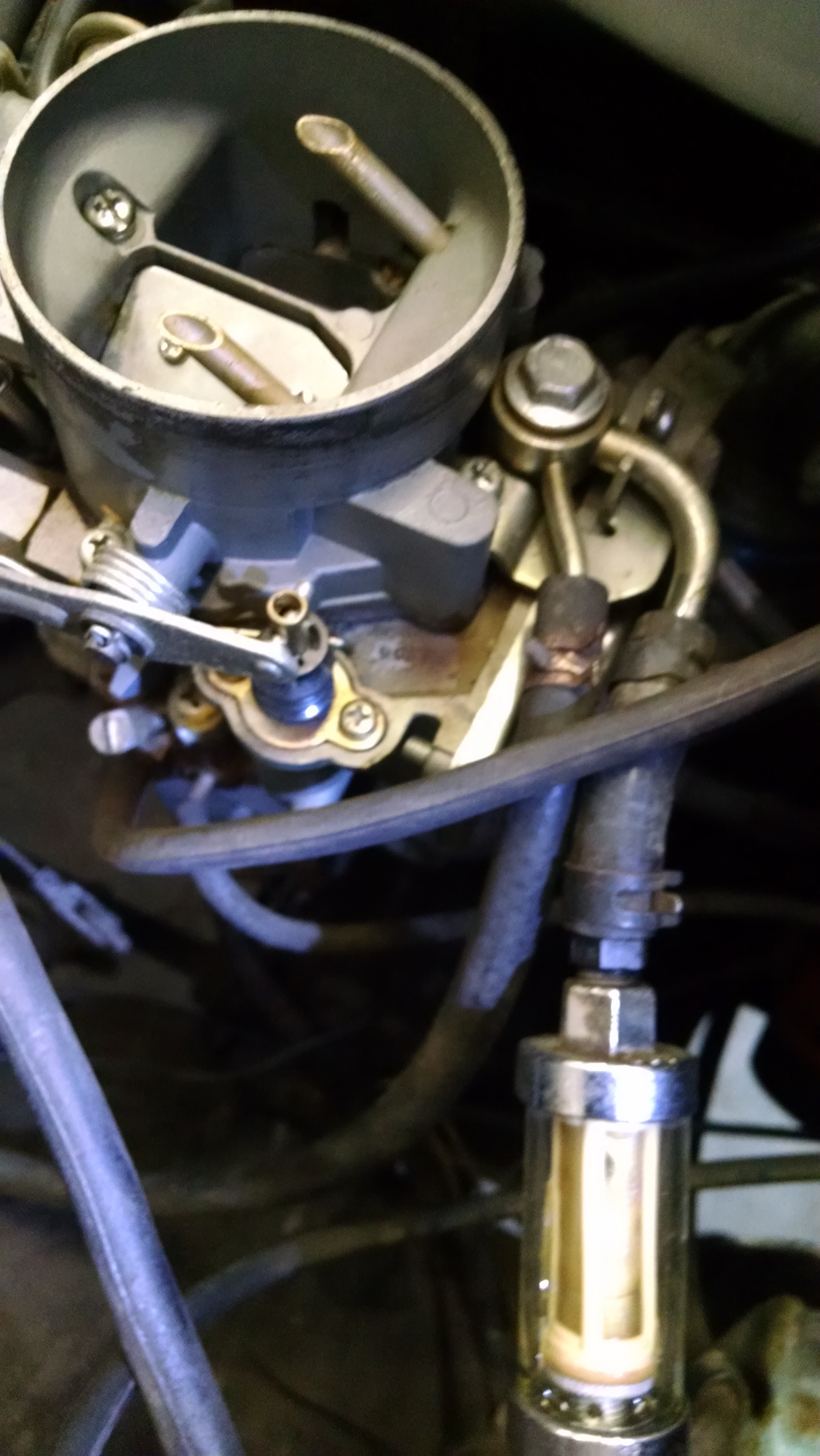

I got my 78 Luv out of storage. Been sitting for over a year.. She cranks fine but won't fire, unless I goose it with carb cleaner. She fires then, but only for a few seconds... Fuel is getting to the carburetor, so I drained the gas tank, put in fresh fuel, checked to see that is indeed pumping fuel, and it is. But still no start... Suggestions? Clean the carburetor? But why does it fire when primed with carb cleaner?
Thanks.
M

Is the bowl filling up with fuel? Check the needle valve. It could be stuck closed.

That does look like the next move..looks like a lot of connections and linkages to be labeled and marked. Any suggestions? I'm not even sure which bolts are holding down the carb!!

The needle valve in our carb gets stuck all the time. Tap it lightly with a teflon mallet around the area where the fuel line connects to the carb.
PostPosted: Sat May 23, 2015 8:09 pm
The needle valve is just below the fuel line. Just the one bolt. If tapping it doesn't help, try taking it out and cleaning it.
PostPosted: Sat May 23, 2015 10:00 pm
Yea, should probably clean it first.
Mine binds and needs to be replaced so I just tap on it for now.
