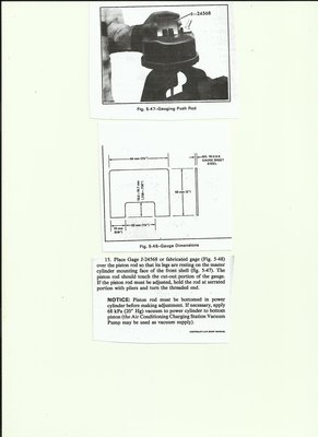

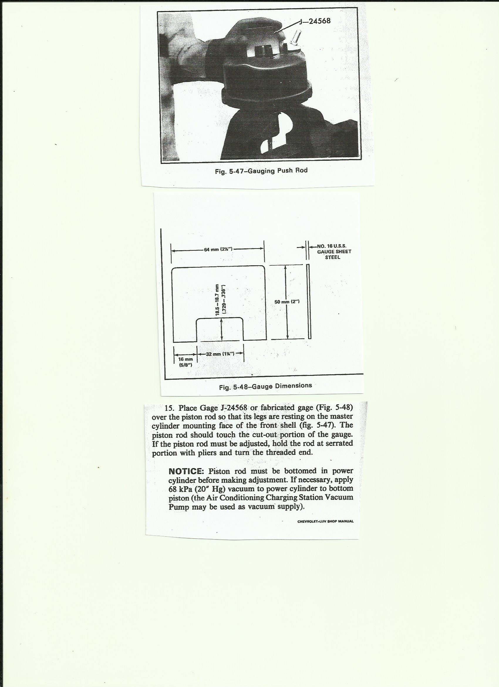

Bench bleed the master before installing. Buy a 18"-24" piece of brake line (M10x1.00 I think), cut it in two, attach to the master & bend the open ends until they can be submerged in a container of brake fluid while pumping the air out. Then make sure the rod into the rear of the master is adjusted to the proper length.

The master kit will likely have instructions, mine did.
You fill with fluid, connect hoses/pipes to the ports, submerge the ends in clean brake fluid, pump the piston with a screwdriver until no more bubbles, install with it full. You'll still have to bleed the air from the lines to each wheel but the master is air free.
