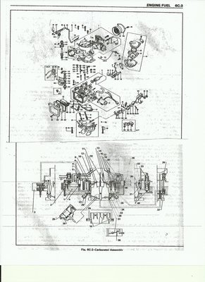

The attached images are from a series 10 FSM, both show the sight glass towards the top.
I suspect you will have to adjust the float level to center the bullseye with the sight window in the up position.
