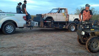

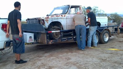

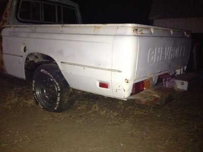

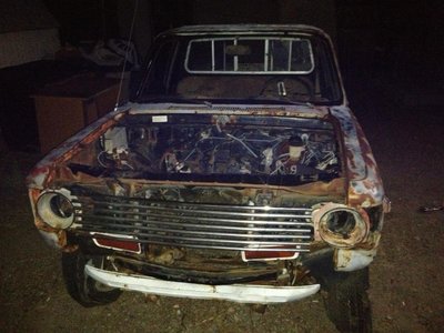

thanks for the repost guys! i actually ran the vin of what they said was a 74..turns out its an 80... i never picked up the 4wd truck due to the hassle of getting where it was at..so i got the 80 cab and a 73-74 bed even though the cab hangs down lower.lights on bed are under tailgate... i have a change to pick up a 01 5.3l silverado motor but would need to fab so i think i might go with the 4ZE1 route since the plan has changed as far as HP numbers..there anyway i can tell what year the frame is? and the other truck did have independent front suspension..also i read up on the rear end ratio..i drive the freeway to work so i dont want to top out at 60..if i can find a rear end to use then i might throw the rx-7 rear end idea out the window(only had that idea so itd have negative camber at all 4 corners)
PostPosted: Fri Aug 16, 2013 11:36 pm
Joined: Sun Jul 14, 2013 8:24 am
Posts: 8

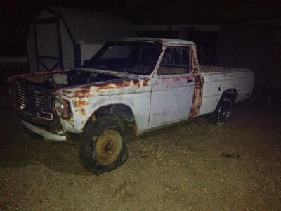

heres some pictures of the truck i figured id post

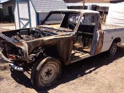

a few more pics

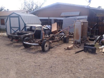

haha ive actually had the truck for a month but i had to move it into my yard so i started pulling everything..i took the doors fenders and grill off the 3rd day i had it..then 4 days ago pulled the cab and only yesterday i pulled the bed,exhaust and drive shaft

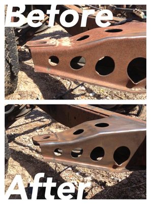

started some clean up
