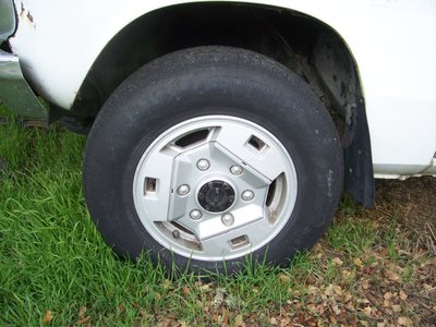

It would be great if anyone/everyone who has found wheels that work well would post pics and original application.
The lug pattern is the easy part. Set back is the trick. Some wheels will bolt up but rub at full turn. Modern wheels (Like from a Chevy Colorado) bolt up but are flush or nearly flush on the outside with a very deep dish on the inside so they aren't a good fit.
Photo is a Nissan "Star Wars" wheel. Bolts up but rubs at full turn.
15" wheels or bigger are fine if tires are not too big.
Mikado is a trim package and is not relevant to the topic.
