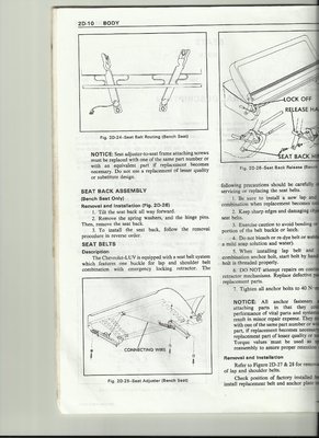

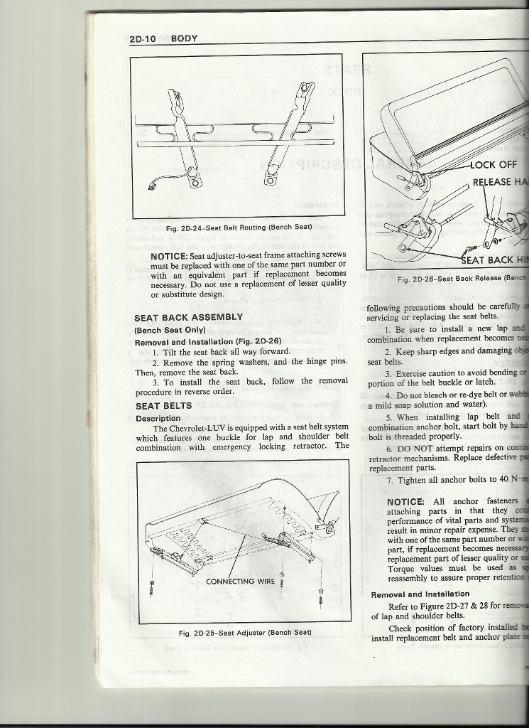

Stupid question, but there is the wire that goes across the seat underneath to the passenger side for moving the seat back and fourth. There is some kind of tensioner thingy that fell off and I can't figure out where it's supposed to connect to. It looks like it's supposed to wedge in between the springs but I can't figure out how, thanks for any help

See if this picture from '80 LUV FSM helps, it's not very plain, but any bigger & it's too large to attach.

That was my other guess :lol: This helps alot, thanks
