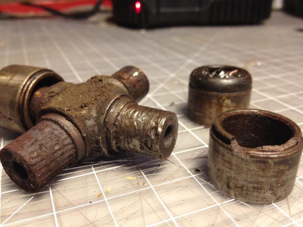

I believe I've found the culprit.
There was noticeable play in the rear u-joint, and zero movement from the front u-joint. As far as I know, the driveshaft shouldn't have any play at all, so I knew I was headed in the right direction.
You can see a complete cap & seal in the upper right side of the image.
The other 3 caps were missing their seals and were bone-dry. The broken cap in the foreground was also missing all of its needle bearings.
The other two trunnions were not in nearly as bad shape as the two in the foreground, which kind of surprises me given the state of the broken one.
I'd been driving it like this for at least 3 months 8O
