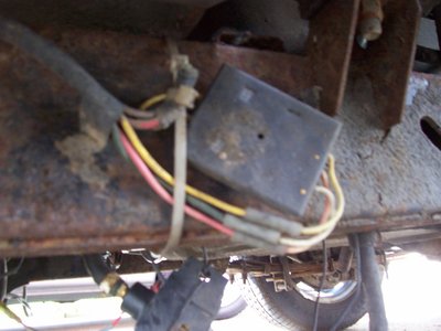

a dead short somehow, which"Could" that prevent a solid good spark? if so, since I'm set up all stock, wouldn't redoing the ignition system(getting a solid, stronger spark) fire her off again? Maybe a msd, with a better coil, or even converting the breaker points to electronic.

As suggested before, it looks like a trailer light converter. Where do the lights run? Is there a trailer plug? If it just connects to lights, it shouldn't affect the spark with the lights off, and I doubt with them on either.

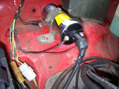

The ballast resistor is bypassed while you are cranking the starter delivering battery voltage to the coil and points. If you could put up pictures of your coil and resistor set up. Regarding your next to last post about your brake and horn and the voltage they are both always hot so with the brakes you will get battery voltage with the ignition off. If there is a dead short your battery should be dead every morning. If its not dead every morning I would consider going with a new ignition switch. How does it run when you push start it? Run your ground cable somewhere else. Pictures more pictures.

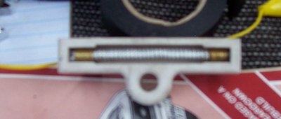

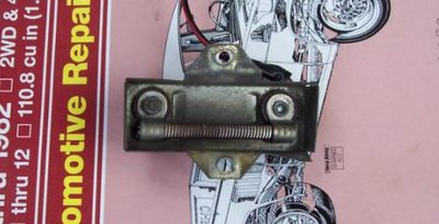

Here are some photo's. I put a Accel super stock coil in so far as the old ones secondary was out of resistance spec. Haven't tried to push start. I get a brighter spark from #1 plug wire, but not blue. jumper from batt. to coil + didn't fire off when cranking over either. hasn't ran since august. I smell gas when cranking. Stock resistor looks burnt. Have a backup one though.

points set up & back up resistor
