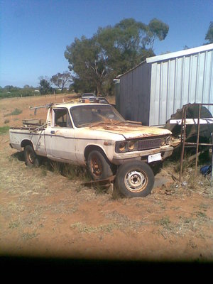

Trailer'd my parts Luv back to the burbs from out the farm, to prepare it for a Ute Muster. Never had it running before because i got it to use as a parts truck. Anyway thought i'd get it running so i could enter in the sand drags at the ute muster. Threw in a battery, topped up the water & checked the oil. Turned the key wound it over waiting for the gas to reach the carb, within a few seconds smoke started billowing from the ballast resister. I checked the wiring and it seems correct, negative wire from coil to dizzy(correct) Black/Blue wire to positive on coil(correct) Black/Yellow wire to ballast resister(correct). Im not familar with gasser Luvs engines, im more familiar with my Diesel Luv. Any ideas as to why my ballast resister is smoking? The Luv runs ok with the ballast resister disconnected but i know its not good for the points. :?:
