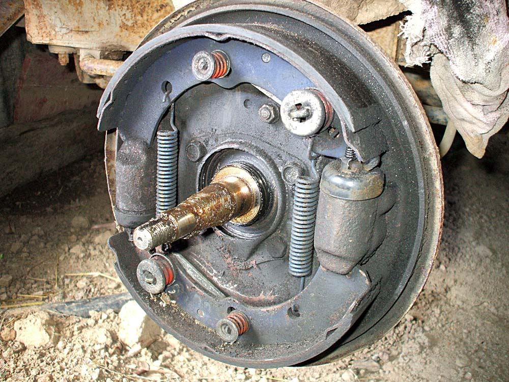

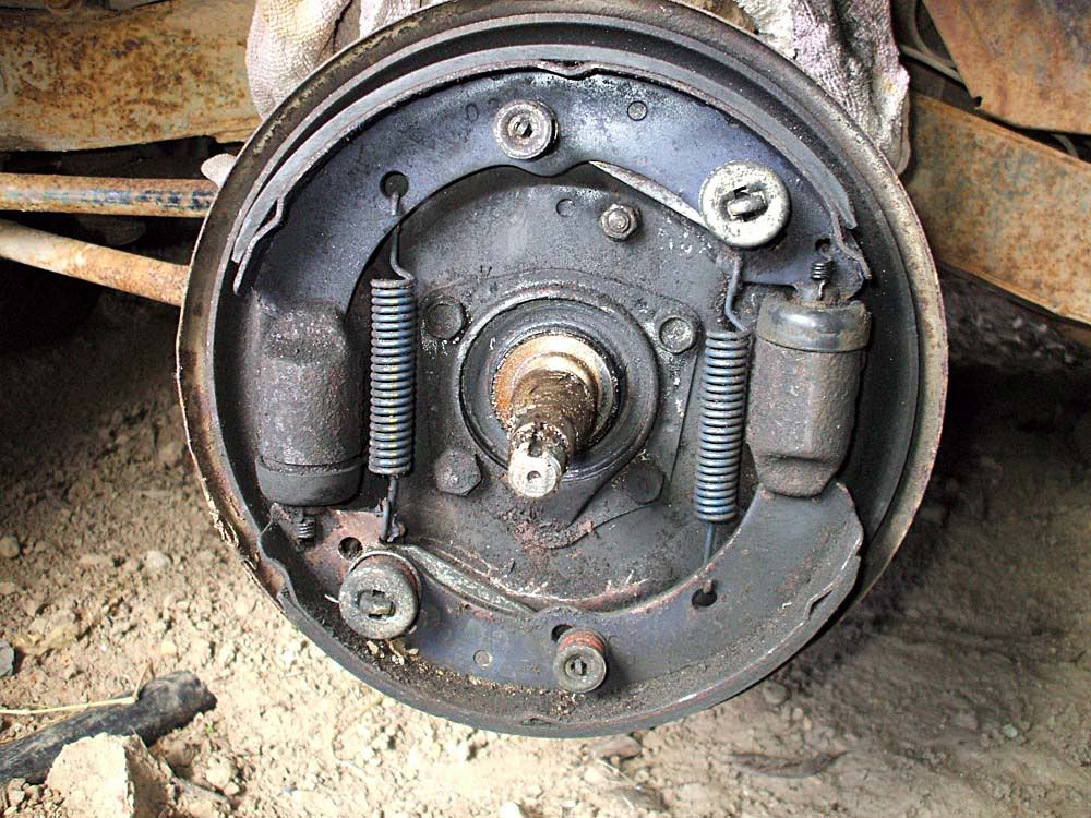

Where are the auto adjuster springs just pulled the hub off a 73.
and not sure what I'm looking at. Is the adjuster stuff behind the shoes?
I'm used to Mazda's I'm afraid with rear drums and manual adjustment.
My olds have an very clean 74 LUV and have been told the springs on their's
are incorrect or faulty. I have found a webb site in the US that can supply many
parts but there are no listing for these springs.
I wouls rather put discs on the front but as good as stock will have to
do in the short term.
Any advise much appreciated.
